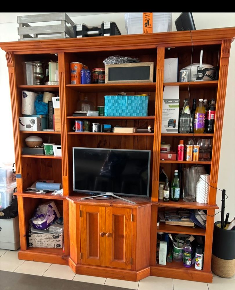

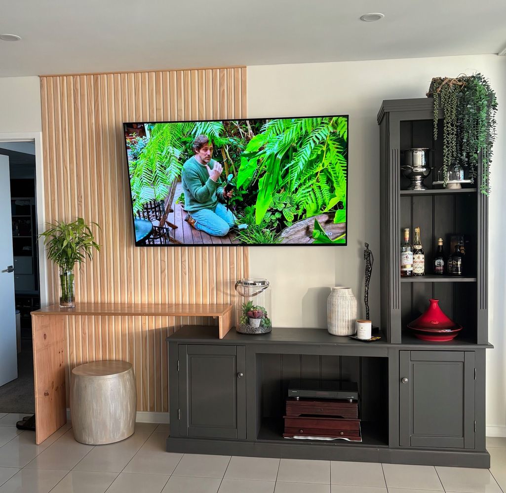

Large 80's orange pine wall unit, upcycled into contemporary cabinet framing large screen TV and feature wall
Centre of lower cabinet squared off, bench top profile reshaped. Upper glass doors removed (removed prior to photograph) and resized and glass replaced with left over 4mm ply sheets. Base moulding patched with trim removed from top of unit.
Left upper cabinet removed and timber sanded and recycled into natural timber return.
Body of unit painted with cabinet paint.
New pine mouldings white washed and added to back wall as timber feature.

Large orange pine dresser items removed and glass doors
(removed previously and stored)

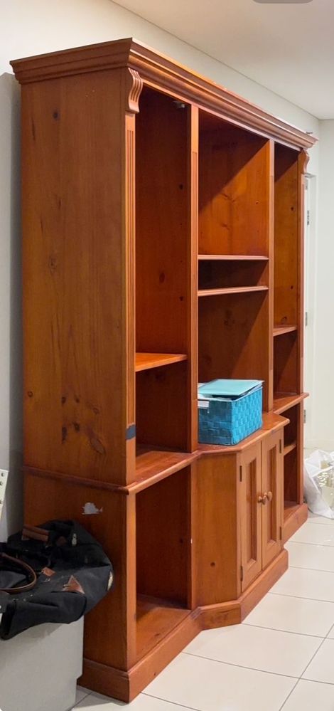

Cleaned with Krud kutter. Unit separated into top and bottom units and front bay cabinet squared off and mouldings from top used to patch base moulding.

Left upper cabinet removed from base with hammer and chisels. Base of top sanded flat and centre front edge of base
reshaped with sander to match sides.

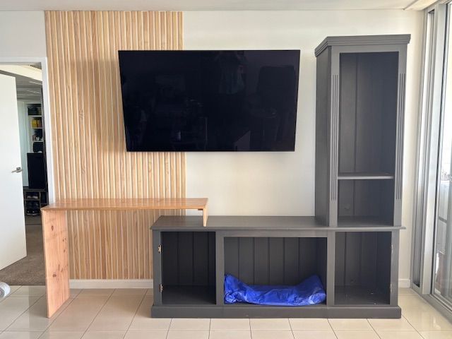

Timber removed from left upper cabinet sanded and cut on Mitre saw to make top and two sides of return. Timber sanded and paintwashed  with paint purchased as mistint from Bunnings and diluted 1 in4 with water. Timber pieces joined at 90* angles with liquid nails and timber screws and Tasmanian oak cover strip glued and nailed to timber edges. Timber sealed with Cabots Water Based Carbothane clear in Satin finish.
Timber return screwed from inside left lower cupboard through bench top and into return with 40 mm wood screws.

Pine mouldings  and quad, lime washed with 3 coats Feast and Watson liming white. Mouldings applied to gyprock wall with liquid nails and 15 mm bullethead nails. 10mm spacer to ensure uniform spacing with spirit level to ensure mouldings remain vertical.
Nail holes filled with Timbermate Pine woodfiller and pine quad applied to neaten top edge of mouldings and fixed with liquid nails.
Doors fitted to bottom cabinets
