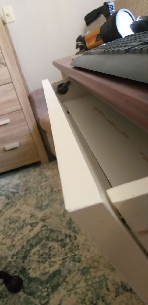

Hi I have just had a large computer desk flat pack built by my handyman however the keyboard drawer will not slide in all the way and sticks halfway out
the drawer sliders were already installed when delivered every other drawer is fine can you give me some idea why and should I perhaps replace them?

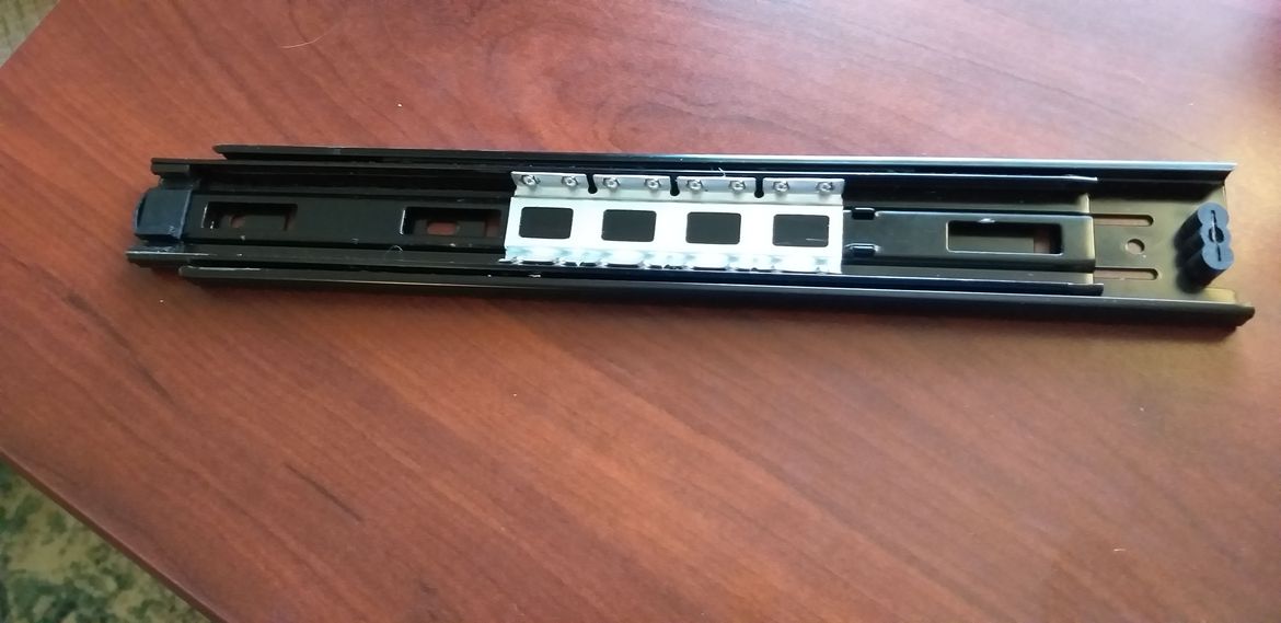

Your first photo shows the door slider fully retracted and your second photo shows it not retracted by a few inches. What is the difference between these two images? Is it not retracting in the second image or have you just pulled it out for illustration purposes? If the sliding mechanism retracts fully without the drawer attached, then it suggestions that either the slider needs to be moved further back on the desk or where it is mounted on the drawer needs to be moved further forward.
If the slider if working perfectly on its own then it is a mounting position issue.

I extended the slider for photo and yes the slider when detached from the desk works perfectly on the drawer when it is returned to the desk
in its original position it sticks again I to have been wondering if it has been mounted correctly at the suppliers unfortunately my handyman had to give up for now had other jobs and was getting frustrated. However I have the tools needed if re mounting the sliders is necessary The second photo of the slider is retracted as far as it will go which is about 13 to 15cm or more from the end of the slider

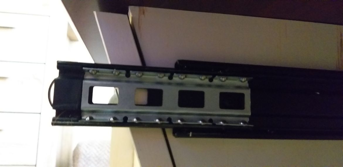

If you see the blue line I've indicated in the below picture, that is the furthermost point in which the slider can be attached. If the slider is moved back to the blue line it is then in the realm of closing. The slider needs to be moved back the length of the current gap that won't close at the moment.
It looks to be a combination of the slider is mounted too far forward and or the draw is mounted too far back. By moving the whole slider mech back it should solve the issue.

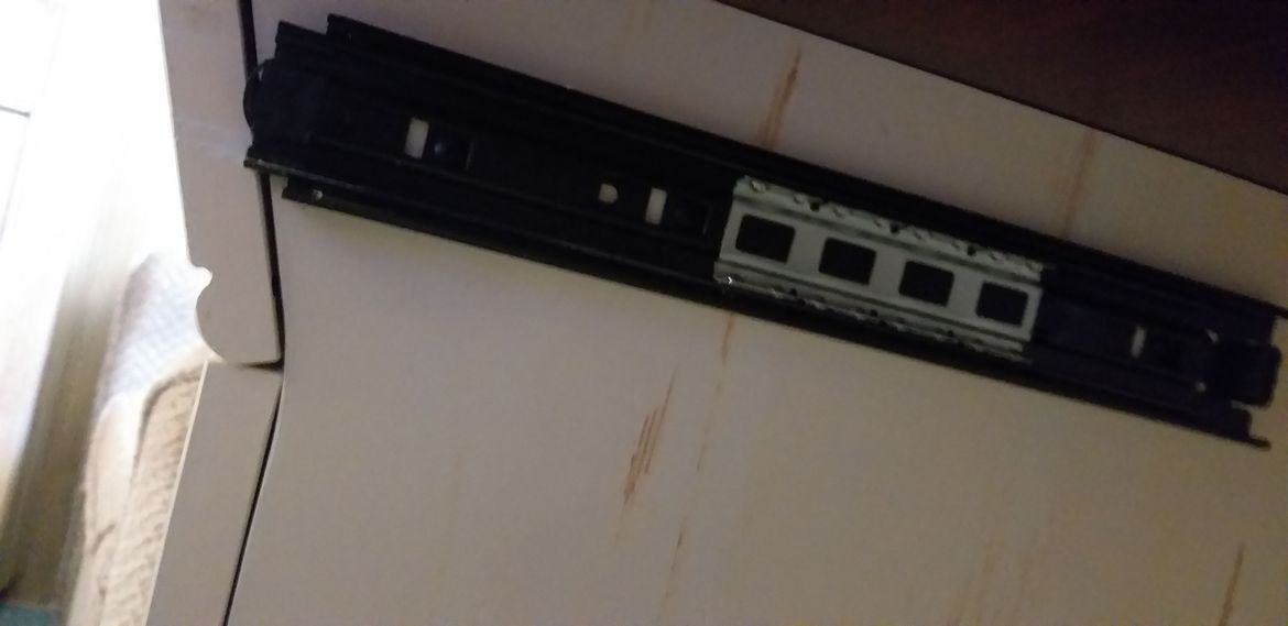

I have just taken one of the slides of the desk and have taken a better photo this is how it was mounted originally note two small prongs stopping the drawer to go any further my thought are it should be turned the other way the prongs acting to stop the drawer coming out to far?
