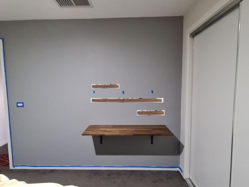

I've decided to mount some floating shelves above the previously installed desk. Just had a few questions I wanted to ask:
I've made this little edit below showing how I would like the shelves layed out. The blue marks are where the studs are.
I will be attaching 2 smaller shelves both 40cm long (1/3 of the desk below it) and 1 big shelf which is the same length as the desk of 120cm. I will be using using the carinya floating brackets here > https://www.carinya.com.au/floating-shelf-bracket-zinc
I understand that 1 anchor point per bracket should be screwed into a stud. The problem I am running into is that, when I align my shelf to where I want it to be, which is the end of the shelf should finish at the end of the desk, in order to hit the stud, the bracket ends up being right in the middle of the shelf, so where will the other bracket go? One bracket will be way longer away from one end of the shelf compared to the other bracket, will this matter? I've always seen 2 brackets having the same spacing apart from the ends of the shelf.
Another problem I think I will run into, is that I might only be able to hit 1 stud per shelf, and the rest of the 2 holes on the other bracket I'll have to use anchors. Will this be okay strength wise? I won't be placing any more than 4KG on each shelf.
Finally, do you think I will have to modify the lengths of my shelves in order to hit 2 studs and have even spacing between each bracket and the ends of the shelf?
Sorry if this was too confusing, will clarify if need be, thank you!

Re: Floating Shelves - Cutting Laminated Board
@prvz27,
Were you still going to have the shelves come out 450mm? I'm just looking at your placements there and it appears you would have a shelf coming out at eye height 450mm on a 600mm desk. 450mm is a fairly deep shelf to have in that position. The reason I am asking is if you had 300mm shelves and only intend to put 4kg on them then the white Ramset screw-in plasterboard anchors would be more than sufficient. That would do away with needing a stud altogether.
My only concern with running with the 450mm shelf and white screw-in anchors is if you put weight towards the front of the shelf it potentially could pull the anchors out.  However, that is 4 anchors which can each hold 10kgs and it should still be fine.
Ideally, you would like the shelf fully supported with evenly placed mounting brackets, unfortunately, this can't always be possible. Even if you have one bracket in the middle and one right to the side they will still serve the purpose of holding the shelf. The only real option other than having two off-centre brackets is to install a third or just anchor into the gyprock with both brackets.

The shelves will be about 280mm out from the wall. I guess I will try to hit at least one stud, if not then just use anchors for the whole shelf otherwise I won't be able to lay it out how I want.

I believe it would be more than adequate to fix both brackets with the wall anchors. Either way, I think 280mm deep shelves are not going to impose too much strain on the fixings, I was just concerned you might be intending to have 450mm shelves.
