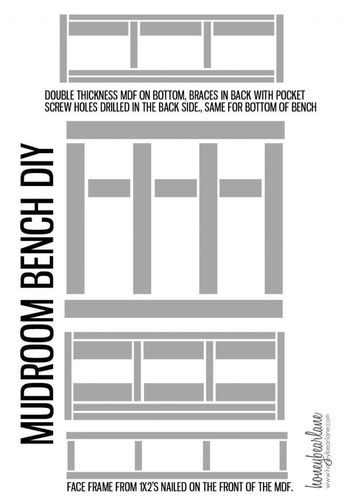

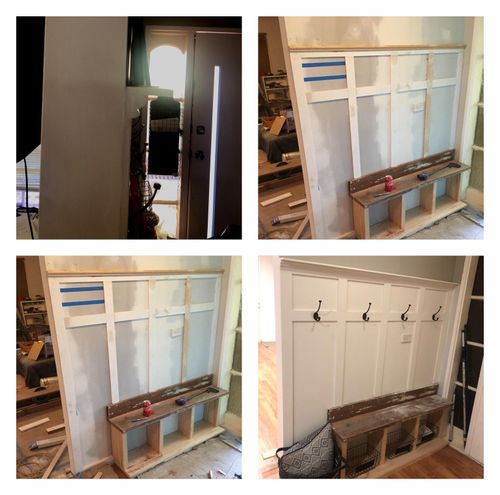

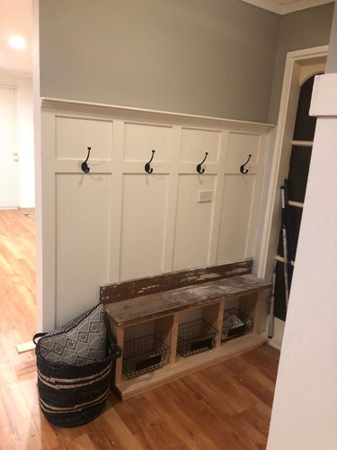

I love the way the American farmhouses have those mud rooms. So I have tried to adapt it Aussie style.
I got the plan from Pinterest and all products from Bunnings.

Fantastic outcome! I have a tiny mudroom here that I have been putting off renovating for a while now...
Sometimes the smallest spaces are the trickiest.
Can you share some photos of how you finished the beading and the gyprock wall on the left? I can see that it is flush to the corner.

From the image provided it appears they fixed the timber beading flush against the corner of the wall. Due to walls not always being straight, it is likely they filled in between the timber and wall with a filler to get a perfect transition. I would suggest a Builders Bog for this application as it is stronger than standard cement fillers. You would fill the gap in between the timber and the wall, then sand the filler back till flush. An undercoat would be advisable and then a top coat of interior wall paint.
If you would like further information about the process, please let me know.

Im a little embarrassed showing you the plan I followed from Pinterest, only because I’m hopeless at following a plan and changed things as I needed ( and I’m hopeless with a level so every one I know reminds me that most stuff I do is slightly out. I saw it adds character. I would change the bench seat if I had opportunity again by making it level with the end of wall.

Cost of the project was hard to work out but roughly about $60- I think the hooks cost me the most. The bottom half seat thing I used some old hard wood I had pulled out from other Reno’s we have been doing in house.
I just used masking tape to use as a guide on wall and used liquid nails to stick wood on and then one nail each end. I just made each end flush with the ends of wall.
