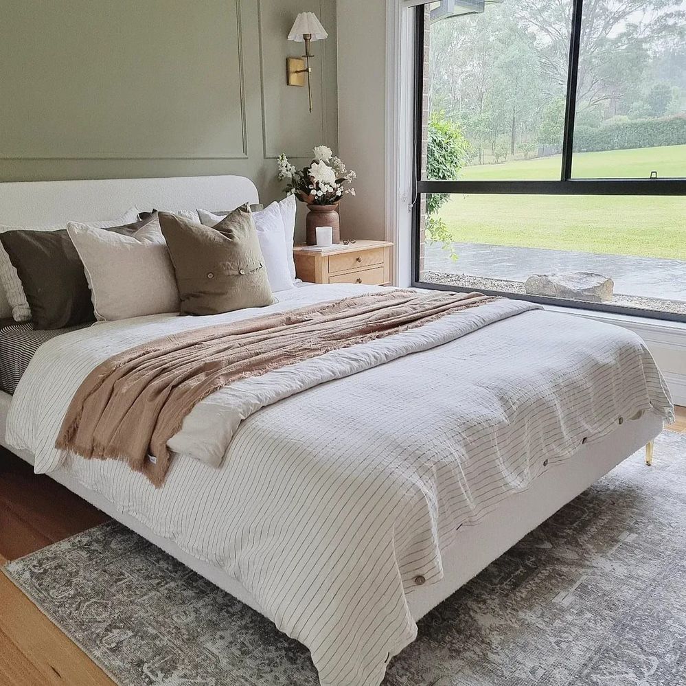

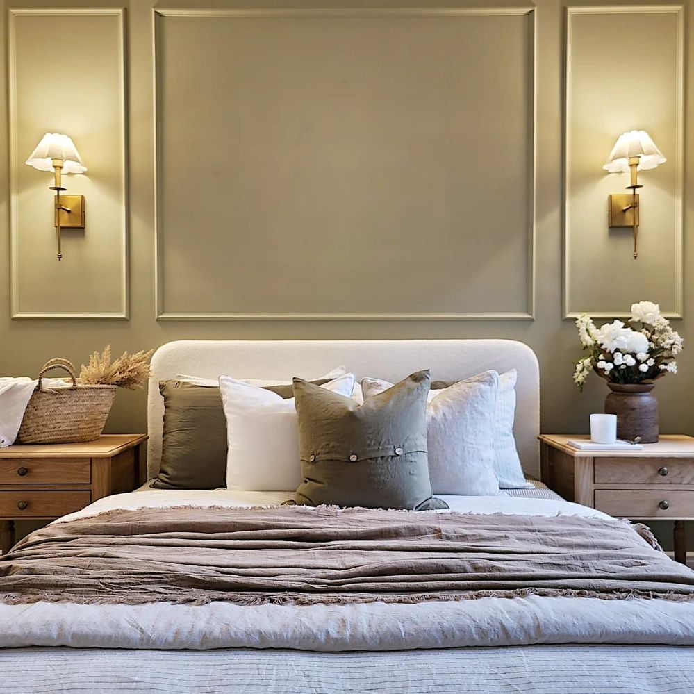

Our Guest Bedroom needed an update and as we often have friends and family come to stay, I was wanting to add character and warmth to the room by creating a feature wall. Using Porta Pine Panel Moulding from Bunnings we (hubby and I) created these beautiful panels on the wall which emphasizes the elegant wall sconces we also had installed. I chose to paint the wall in a divine muted, mossy green tone 'Green Result' by British Paints. Being budget conscious though we chose the brand Spring flat interior paint from Bunnings which under $20.00 for 4 litres is an absolute steel! I was so impressed by this paint too! It had amazing coverage and the most divine, silky matt finish. I completed the room by styling with some new bedlinen and decor pieces which bought everything together. This was such a simple, cost-effective project that could easily be done in a weekend with such amazing results!

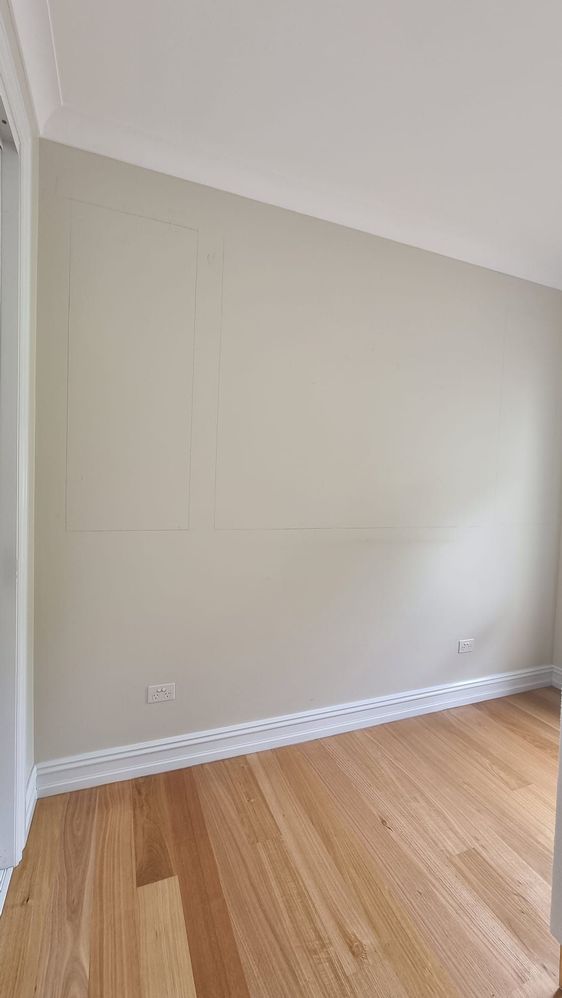

MARKING OUT POSITIONING OF MOULDING ON WALL

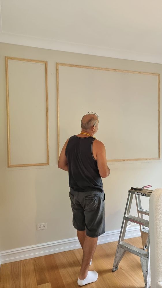

INSTALLING MOULDING

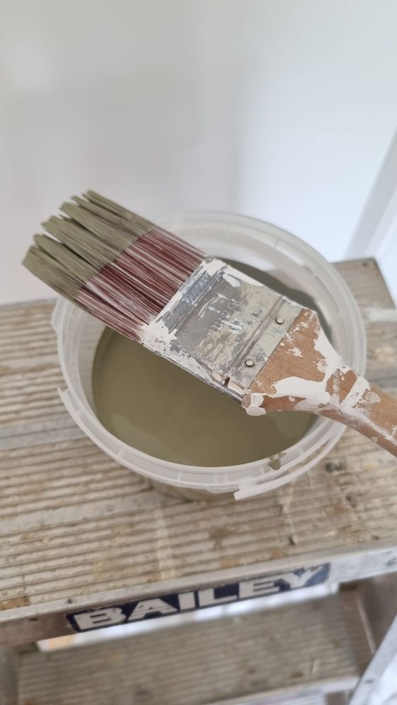

READY TO START PAINTING

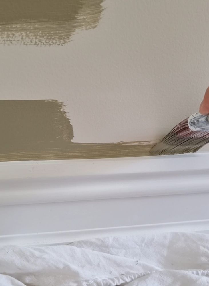

CUTTING IN EDGES WIRTH PAINT
FINAL STYLED ROOM-MAKEOVER COMPLETE

2. Measure out and draw where you would like the Moulding to be placed.
3. Cut Moulding to size & install using liquid nails or nail gun (hubby used a nail gun)

5. Mask up wall if needed - we did as I was painting a darker feature colour I wanted a crisp clean line where the walls meet in the corners plus using tape is far easier than trying to cut in perfectly.
6. Start by painting one coat on your moulding, then cut in all your edges then roll main areas.
7. Apply two coats of paint. 3 if needed if coverage is uneven.
