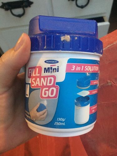

I used Monarch Fill, Sand and Go filler to cover any deep scratches and a small chip on the wood. This stuff is easy to use and you cannot see it under paint!

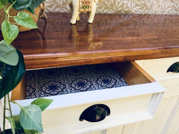

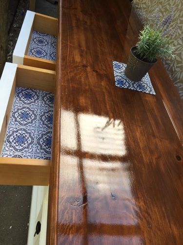

After an allover 240grit sand, I used my favourite paint, British Paint interior. 2 coats covered the old brown/orange stain. The top I stained with one coat of rich, dark Walnut. Stain was protected with Polyurethane spray in gloss.
The metal cup handles got a quick spray with Fiddly Bits Black Spray Paint (Gloss).
The drawers needed something exciting to give a pop of colour while still keeping the crisp clean feel.
Wandering around my local Bunnings waiting for inspiration and I found IT!!
Boyle 1.5m x 45cm Self Adhesive wallpaper in the Vintage Blue Tiles pattern. So many styles and patterns available in self adhesive wallpaper that's easy to use and durable.
A quick spray and wipe inside with wood conditioner and this beast was a beauty!
