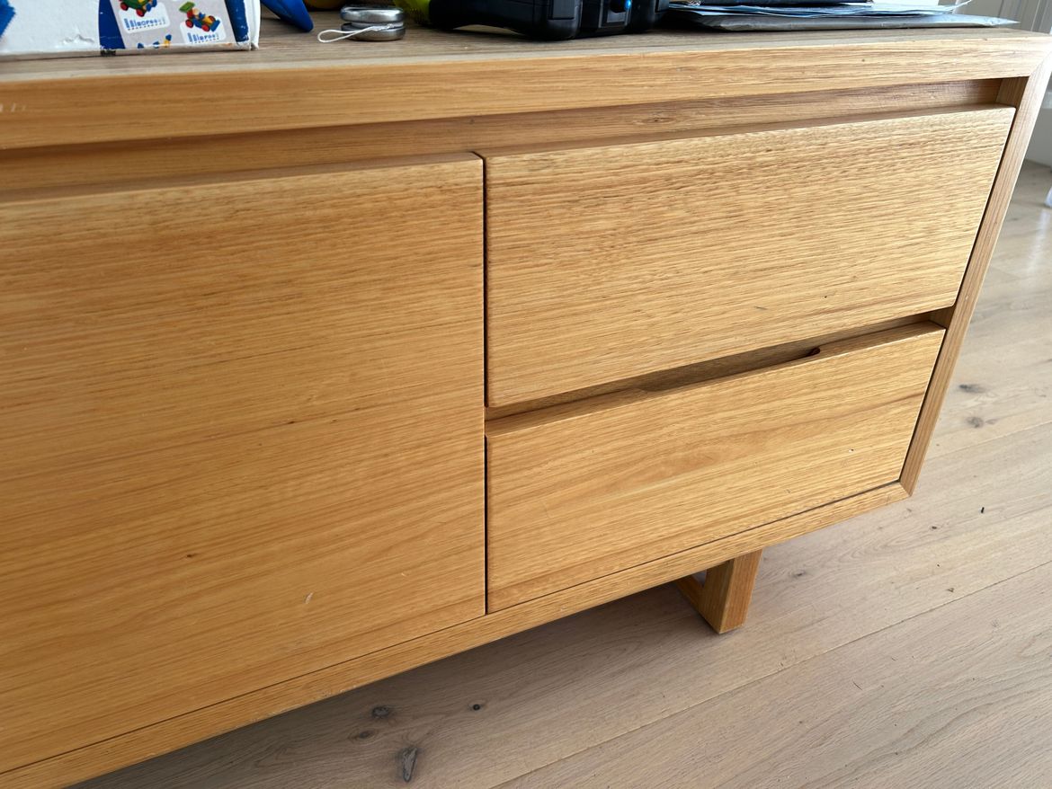

What is the safest product to removal/ strip the polyurethane coating from this unit?  The veneer is Tasmanian Oak. IMG_9253.JPG

If you are certain that it is a timber veneer, I suggest using an orbital sander with a 180grit sandpaper attached. Because the veneer is very thin, I suggest doing a single pass to test how much polyurethane it will strip. I propose doing a second pass if the surface still seems covered in polyurethane. Your goal is to remove the light coat on the surface without compromising the timber veneer on the surface. Once you are successful with removing the polyurethane, I suggest finishing the surface with a 240grit sandpaper to bring back its smoothness.

Thanks for your advice Eric.
I tried that technique on the top and found it took a lot of grunt to remove the coating. I accidentally removed too much veneer on one corner and have learnt that lesson.
Is there a stripper that could assist to make it easier to do the rest of the unit which includes the trickier details of doors, draws and legs?  Or is sanding the best way given it is veneer?
