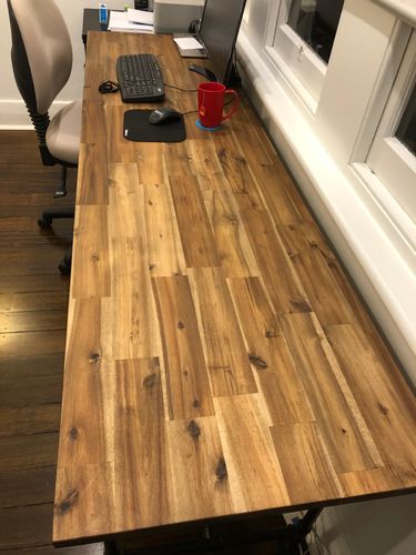

Acacia bench/panel 2200 x 600 x26

THE DESK legs and feet were adjusted for level, a few mini coach screws from underneath the table top and that was done.

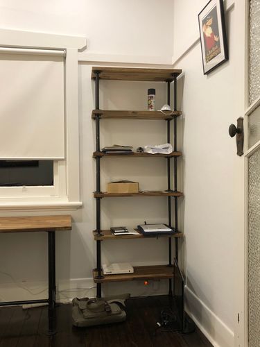

BOOKSHELF was the last to be assembled ... First the uprights were grouped in 4's of the same height to aid in levelling the unit, then with only 96 holes drilled and filled with 96 specially ordered matt black nuts and bolts it was all done...AND....

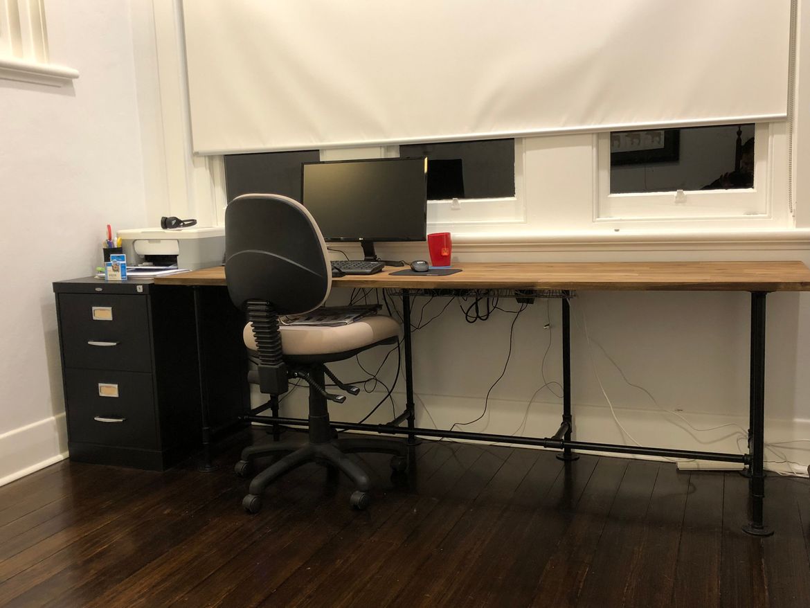

The final product is below....

Shelves

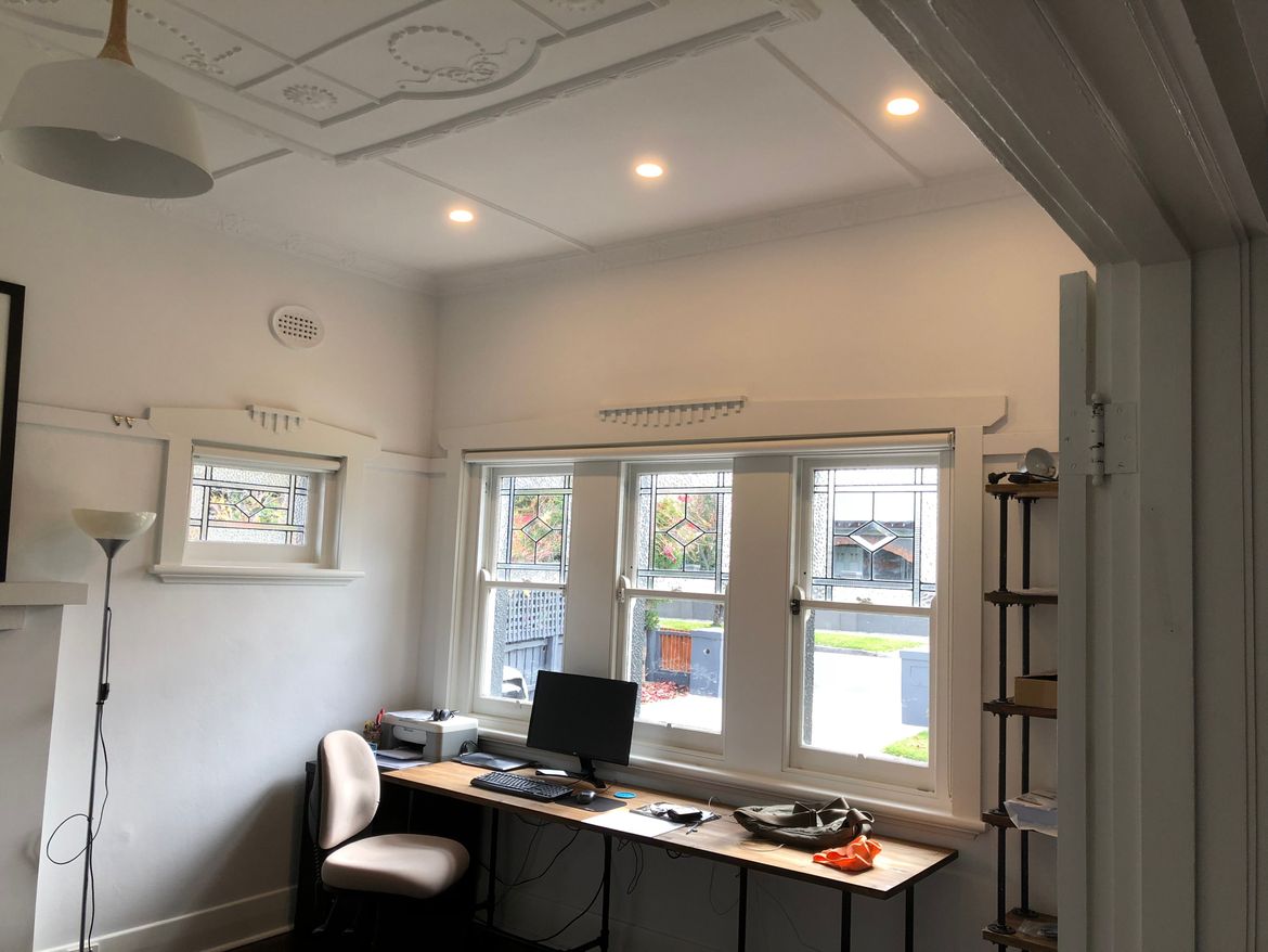

Only additional bit of work was to bring in an electrician who put in some down lights:

Hi @Isobel thanks for your suggestions, I had the same thought of tidying up the cables to give it that clean open industrial look and went with this cable caddy from Ikea.... as you can tell from the photos in my post its pretty useless!
Annoyingly, I'm unable to really tidy it up properly by going through the wall, as its a double brick. Also something I neglected to mention in my original post is that the whole project is designed to be portable/free-standing so it can be moved into another room/space quite easily. Otherwise I would have just used a substantial wall cleat and some nice angled brackets for a really clean open finish look.
Alas I am yet to find a cable management solution that is perfect. On the one hand I need it to house a 6 gang powerboard with space for 5 bulky transformers (printer, phone, laptop, modem, router)... but at the same time be something I can use to tuck away a few extra long USB cables..... yet also have access to be cables to unplug a laptop & phone charger easily enough when I work out of the office or travel etc.
Might look into something like an opened up section of PVC pipe, or even just using washi tape to brighten up and make a feature of the cables thay I just can't tuck away.
The other option would be to screw the powerboard into the underside of the table and use some sort of cable management clips/cable ties to keep it all tucked up...

On this one I cant ues extension cables as Im trying to keep all the cables up as high as possible to keep them out of view rather than running them down to the ground or through the pipe etc, although switching to all black cables and running them beind the legs would camouflage them pretty well.
My original plan was to have the cross beam running along the back between and connecting all 4 of the rear legs but I couldnt get any 4-way connectors even though bunings does advertise them. In any case it turned out to be a bit of good luck having them centred as when I sit at the desk it works perfectly as a foot rest and if im at a join with a connector it makes a good foot massager as well ![]()
