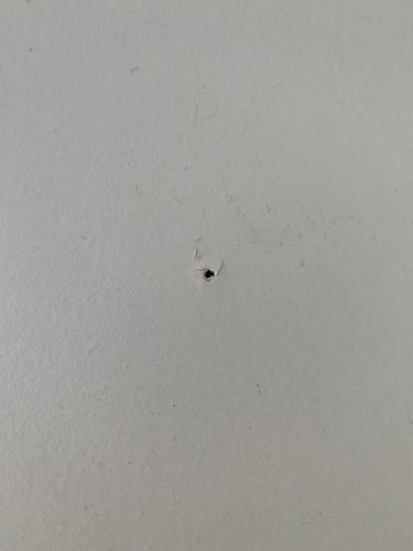

Hi folks. I recently bought an apartment in a 1970s brick block, w/ rendered brick interior walls in fairly shabby condition. It’s a fixer-upper. Every single wall is so badly textured that I thought it must have been the render itself:
Every single wall in the place looks like this…

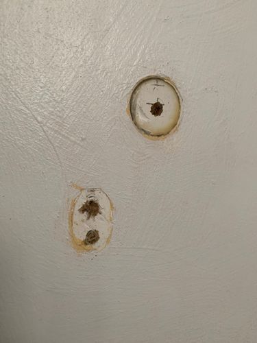

But upon closer inspection, I think the real culprit is the 50 years of bad paint jobs:
But from what I can tell, the problem is entirely the paint, not the wall? Wall seems perfectly smooth under all that.

Perhaps you can test a portion of the wall. As you've posted a picture I agree with your analysis that it is a bad paint job. Lets use a light duty scraper https://www.bunnings.com.au/uni-pro-100mm-real-good-paint-scraper_p1674113 Starting at the corner of that photo with a hole in it gently run the scraper under the paint and see if it will peel or lift using the scraper. If the paint comes off easily and large sections go with the scraper I suspect there was no primer used hence the paint comes off, but the problem was aggravated as more paint was laid on without removing the first faulty layer. However if it becomes very difficult to remove the rest of the paint I suggest to stop and possibly use a grinder with this disc https://www.bunnings.com.au/3m-4-inch-paint-and-rust-stripper-abrasive-disc_p6314180 fair warning I would probably be gentle with this as we don't want to eat in to the rendered wall adding more jobs to an otherwise difficult job already. If you do make a mistake it can be repaired with Render joint and patch from Dunlop. But our primary goal is to explore how bad the paint job is, how long did it take you to remove the bad paint on that single wall and is it worth the time and effort or do we just re-patch and paint? If you cleared the wall in reasonable time then it should be worth doing the rest of the rooms. Slow and steady for this test.
1. First we test if we can strip the bad paint with our light scraper on the test wall. Too hard? Then use other means to strip paint. ( electric tool and 3m paint remover pad etc. )
2. Time yourself, how long did it take to strip 1 wall? Too long then you might need to re-asses your goal for this paint job. Finished it in reasonable time, then proceed.
3 Assess the condition of the wall and ask your local Bunnings paint specialist on how to prep an old brick wall that's been rendered. Purchase necessary primer and paint and have at it!
I hope this has given you ideas on how you wish to proceed, please post if you have any other questions. If you can please post your progress with photos and comments on the job, it would be much appreciated and will help other members who are in the same boat as you! Good luck and stay safe. Looking forward to the progress!

While we are on the subject of testing, if you have difficulty removing the paint and you start doing damage to the plaster/render, have a go at sanding the stroke marks out of the existing paintwork instead. A random orbital sander with 240 grit paper would remove them quite quickly. You could then prime and paint over it with a roller. I suspect the paint has adhered reasonably well to the wall and the chip you have pictured has only come away due to the fixing in the wall.

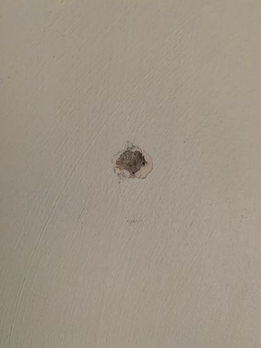

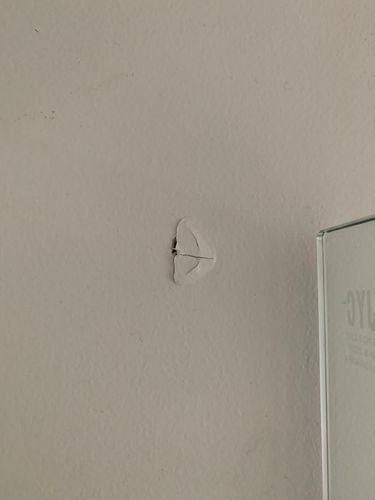

I’ve started removing the many pre-existing hooks and nails in preparation, and this has left behind various degrees of damage for me to fix up. Would this polyfilla here be the correct product for that? And should I apply it as part of a separate process AFTER I have already sanded down the thick paint?
And lastly, would the same 240 grit paper on the sander do the trick when sanding down the polyfilla? 😁
Hello @OneMansFool
Yes use the filler first to repair all the holes before putting on any paint. Yes the 240 grit will be more than sufficient to sand the filled holes. Using the sander should shorten the prep time for sure.
Red
It's great to see you've already received a helpful response from @redracer01. I just thought I'd add that you should scrape those loose chips off that have delaminated around the holes before filling. It seems counter-intuitive as it will make the damage look worse, but they are now proud of the surface and applying filler over them won't be particularly effective. Remove the chips and then fill their void back up with filler flush with the surface of the wall.
