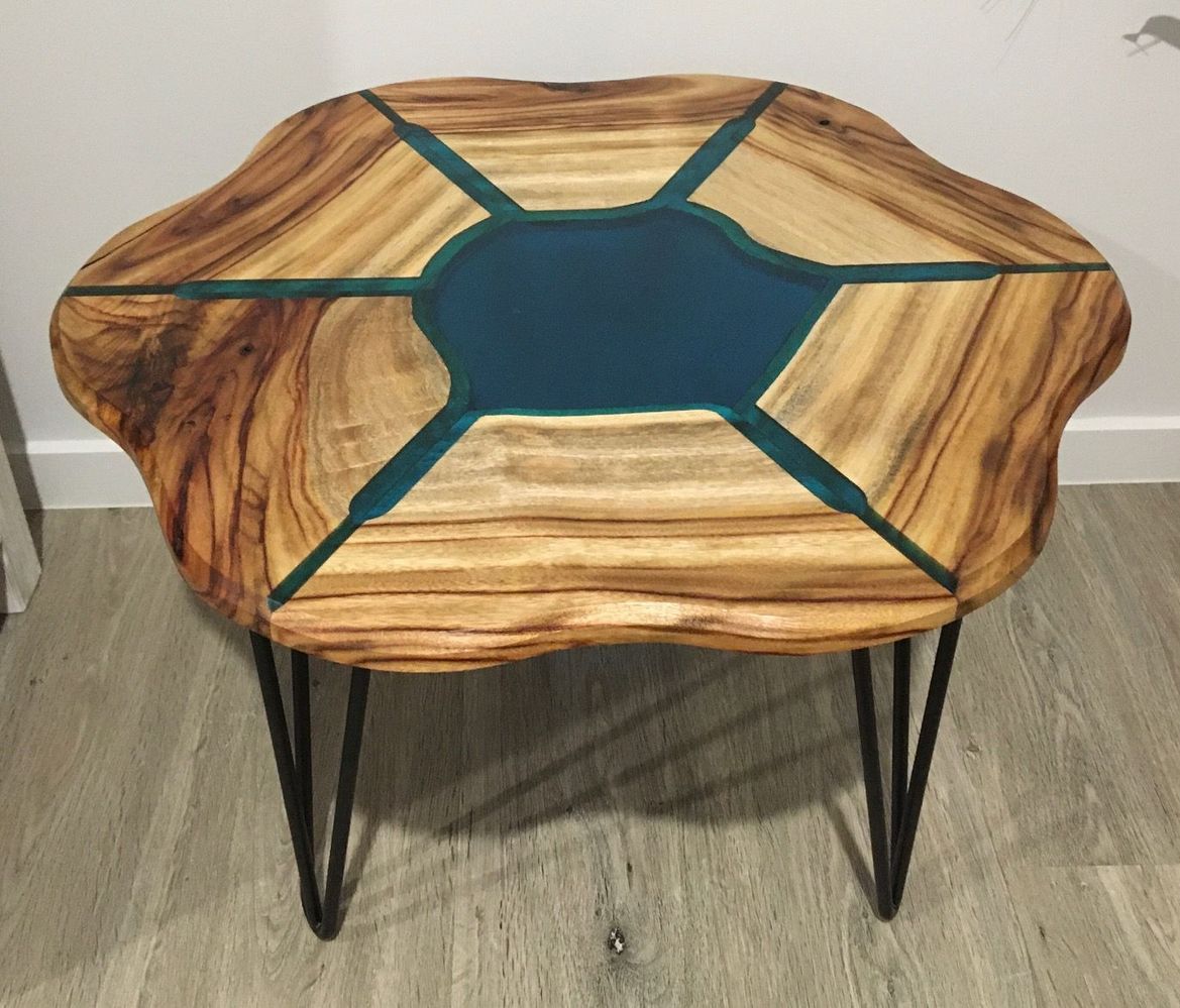

How can I improve the finish on the resin ?
BillN
Budding Contributor
 Resin & camphor laurel timber.
Re: How can I improve the finish on the resin ?
Welcome to the Bunnings Workshop community @BillN. It's fantastic to have you join us, and many thanks for your question.
That's an absolutely stunning table you have there with an amazing finish on it already. Did you make this yourself? What exactly would you like to improve on it? Are you envisaging a "wet look" glossy finish instead of this natural matt one? If so, a product like Feast Watson 1m² Glass Finish would likely achieve that for you.
It would be great to hear more about what you would like to improve as I think it looks amazing.

Hi Mitchell,
yes I did make it , not sure if I have sanded the resin enough to get the “glass finish”. Thank you for your recommendation for the Feast Watson product.

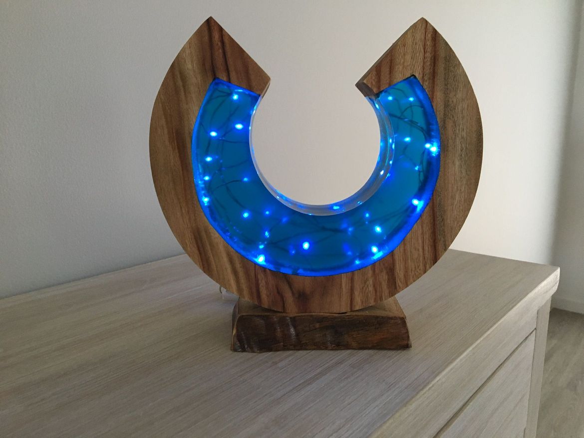

just a beginner with the resin & timber work.This lamp was another I made, learning from mistakes as I go.

@BillN
to get the best results you will need to use 240 grit 320 grit, grit 400, grit 600, grit 800, 1200 through to 15000 grit followed by a liquid polish. I use this process when making pens. you can get packs of these grits from Timberbits, Sand paper man, Pops Shed and any other place that supplies materials for wood turning
Hi @BillN,
I see @r23on has provided the solution. Resin transitions from opaque to clear after the 1200 grit mark. I've managed to get reasonably clear results moving from 1200 grit wet and dry sandpaper to an automotive cut and polish. As @r23on has mentioned, getting perfectly clear resin requires you to step up through multiple grits right through to 15000.
What grit have you gone to already?

Hi r23on,
thanks for the reply, I think I also used too much colour in the resin for the result I wanted.
I need to look at buying higher number grit .

Hi Mitchell,
I don’t think I was anywhere near 15000 grit, I did use wet & dry but not sure it was over 1200.

Once you use the hight grit that will change however you will have a darker colour
I am having trouble uploading a photo as soon as I can sort it out I will upload a photo. in mean time try some of the places I gave.
That is a nice pice of timber ist it camphor laurel?

Yes its camphor laurel. It was an idea to do something different as a first project instead of a square or rectangle table top.
Your finish with the 15000 looks great.
