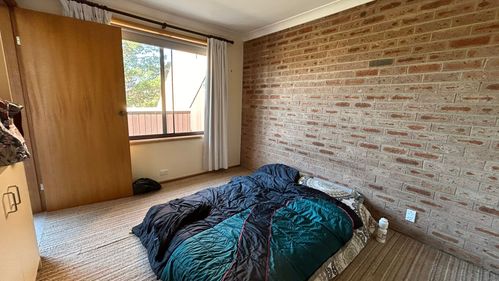

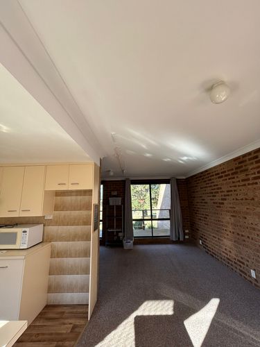

I've got a really ugly internal brick wall I'd like to modernise using timber planks. I thought the easiest/cheapest way to achieve the look I'm after is to attach this kind of hybrid vinyl planks: https://www.bunnings.com.au/smart-home-products-2-42m-arctic-aquaguard-waterproof-hybrid-planks_p0147504
The wall is 6m x 2.34m. How do I prep the brick? How do I adhere the planks to the wall?

The Smart Home Products 2.42m² Arctic Aquaguard Waterproof Hybrid Planks is a flooring product and not specifically designed to go on a vertical surface.
If you were to attach such a product to your brick wall, I recommend lining the brick face with plywood first and fixing it in place with brick wall plugs, screws and adhesives. The purpose of the plywood is to give the brick face a flat surface.
The flooring planks would then need to be glued directly to the plywood. Please note that such an application would probably void the warranty of the product. It is difficult to tell how the product will behave long term in such a configuration.
The other options as are to use EasyVJ Panels, 12mm OSB timber panel, design panels and wallpaper.
