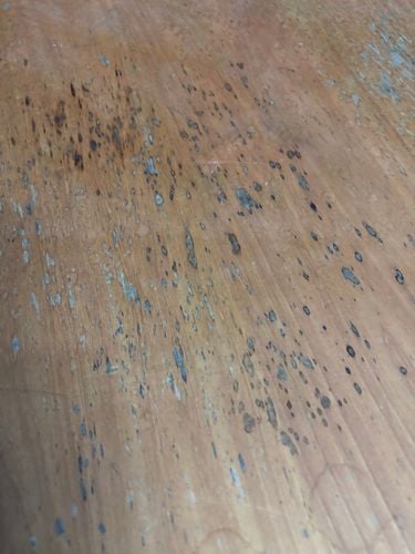

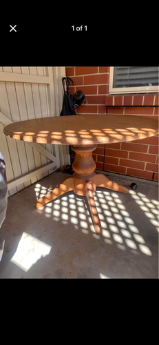

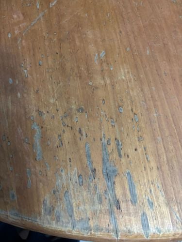

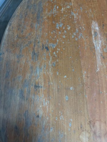

I bought this wooden table from FB marketplace and plan to give it a second life. It has a beautiful solid wooden base but the wooden top has certainly seen better days. There are watermarks and some black spot damage. Looking for advice on what the black spots may be and how to best approach the task of removing them?

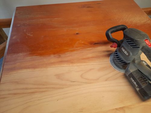

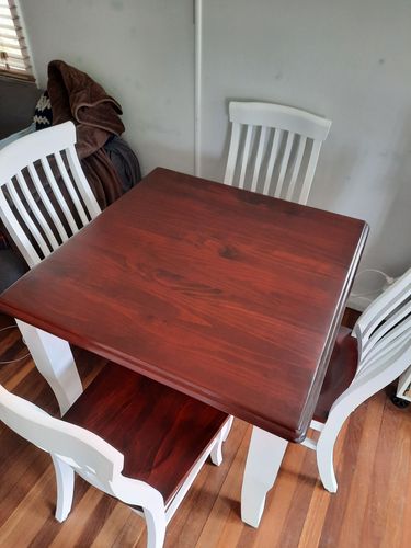

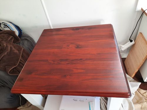

My table was in similar condition, perhaps not as bad, but after sanding it down with 80 grit on an orbital sander, then 120 grit, it came up great and ready for staining. There are more details on my steps and products used on Workshop here. After two years, the top has held up really well, not sure I'd use chalk paint again (for the legs), not as hard wearing but it does still look good and it stuck well to the keyed varnished surface.

It sounds like you’ve got a great project on your hands. Those black spots are most likely areas where moisture has penetrated the wood, causing minor timber degradation, since the original finish has worn through. Watermarks are also a sign that the protective coating has failed in places.
As mentioned by @twocutekelpies, the best approach is to start by carefully sanding back the entire tabletop to bare timber. You want to remove the existing coating completely, along with the blackened or damaged areas. Start with a coarser grit to strip the old finish, then move through finer grits to smooth the surface and prepare it for re-coating. If the black spots are only superficial, sanding will remove them, but if they’re deep, you might need to use a timber cleaner.
Once you have a clean, smooth surface, you can decide whether to apply a clear protective finish like Cabot’s Cabothane to keep the natural timber look, or to stain it a darker colour if you want a refreshed tone. Either way, sealing it well will prevent future water damage.
