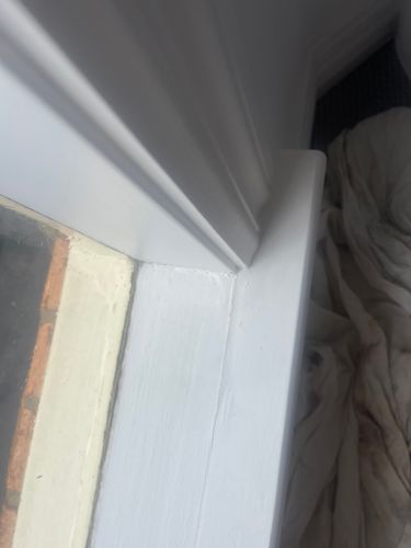

 Hi, Used new brush and applied paint after sanding and lengthy stir. Appeared to blend in after 1 hour or so (1st image) then darker shade when dried. Paint color cotton ball white 7 years old. Suggestions welcome - use primer,  cover with wood or spakfilla , buy fresh paint? Thanks

Where exactly did you repaint? I notice all the pinkish-hued areas from your first image in this discussion are now gone, but you have a darkened area around the architrave. Did you paint over the whole windowsill?
I didn't notice in your paint pot images that this is a seven-year-old paint. Given its age, I'd say that could be the reason for unusual results. I'd recommend picking up some new paint.
You could potentially use a stain-blocking primer, but I'm not particularly convinced this is a staining issue. Your current issue looks far more like a stain bleeding through than your first images, but my money would be on the paint being the issue. A stain-blocking primer wouldn't hurt, though.

the darkened area in the image is the only area that I painted as a test not whole windowsill. I will get new paint and try that. Stain blocker after that if not successful.

Can I ask what happened to all the pink area we were previously discussing, if you only repainted the darkened area in the current image, @Willy7403? Those details might help me better understand what's going on here.

Yes that’s a different window. My test was on another window.
