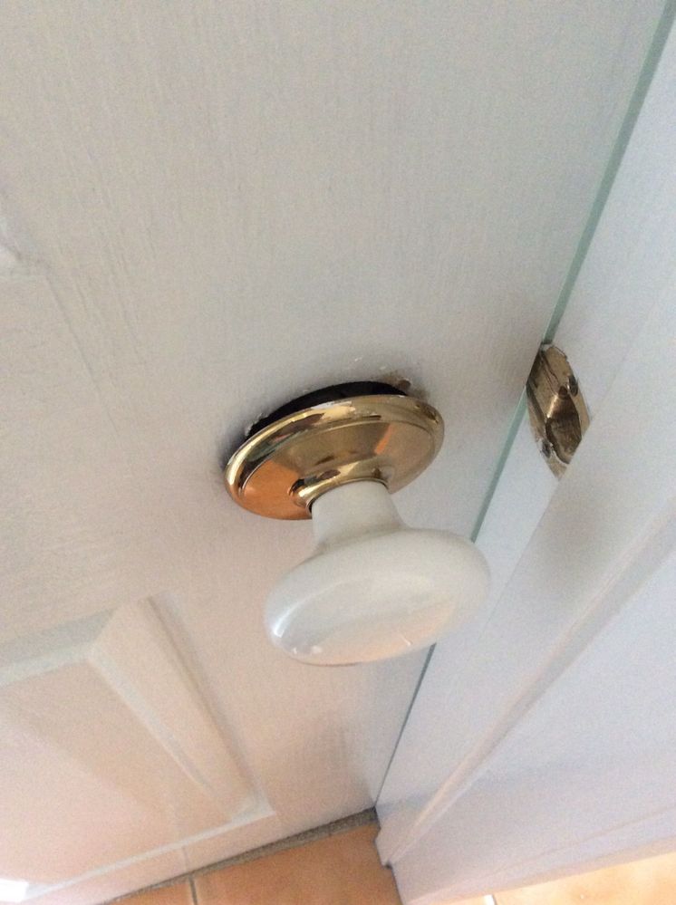

How do I repair a loose door handle?
Pammyg
The door handle is very loose, almost falling off the door. I have wiggled but can’t work out how to tighten. I have studied your how to replace a door handle but mine are a bit different. Any advice will be greatly appreciated.
Re: How do I repair a loose door handle?
Hello @Pammyg
Thanks for sharing your question about repairing your loose door handle. Would it be possible for you to post a photo of the other side of the door? I believe that the adjustment points are on the other side.
Once we see a picture of it, we'll be able to offer more recommendations.

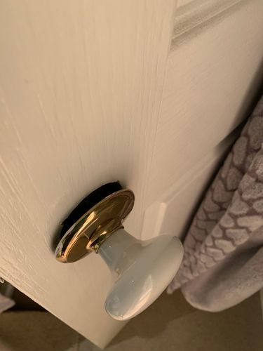

Hello @Pammyg
Thank you for posting that second picture. I suggest having a look at this discussion - How to fit Gainsborough Classic passage set? by @Dubya. You'll note on the discussion that the gold plate cover is attached to a fixing plate. These two parts must be separated in order for you to access the screws that bring the assembly together.
I've placed the assembly diagram below, please have a good look at how the parts go together.

Thanks Eric I will give it a go tomorrow:))

Thanks for all your help, I have tried but to complicate things I broke my left wrist 8 weeks ago and is still not very strong, so I have not had any luck. Now waiting on a visit from my son to give me a hand.
Re: How to fit Gainsborough Classic passage set?
Hello @Pammyg
I'm sorry to hear you've injured yourself. I hope that you have a speedy recovery. Please make sure to show your son the diagram I've posted so that they'll have an idea of how it's put together.
If you have any other questions we can help with, please let me know.
