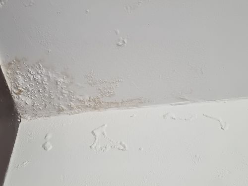

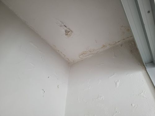

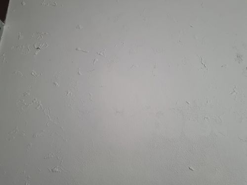

Hi, there is persistent water damage in our building and this bedroom wall has been repainted several times but keeps bubbling up. Seems as though we are starting to get mould now. Can anyone confirm this from these photos? Is there any way to fix this so that it is safe to sleep in this room for a bit longer without the original building issue being fixed (we are unsure when this will be possible)? Thank you.

Do you know what material the wall is made from? If it is brick or concrete, then once the current bubbled paint is removed, you could apply WATERTITE-LX Mold & Mildew-Proof Waterproofing Paint to the masonry. If there is a constant water leak above, then applying this paint will divert the water elsewhere in the wall. It's really an issue that needs to be resolved at the source, but I understand that this is not always possible. Any waterproof paint applied over the existing paint will continue to bubble off as it needs to be applied directly to the underlying masonry surface.
I do not see much mould in your images, mainly just water stains. There are additives such as the Protite 50ml Mould Defender Paint Additive, which can be added to standard paints. However, they will not help with the bubbling you are experiencing. Personally, I use a capful of clove oil in a litre of water spritzed over the area to deter mould. It's an extremely effective solution, which kills the spores and isn't as noxious as using bleach in a bedroom.

Thank you so much Mitchell. You have given me a little bit of relief, but I'm still quite anxious about it as it is our child's room. I'm sure that the painters have only ever used waterproof paint and not applied anything to the masonry. I will speak to the agent about it again and see if they'll get someone to try that or let us do it. In the meantime, I will try the clove oil! We are hoping to move to save ourselves the stress but it's not happening as quickly as we would like. Really appreciate your help and advice! Thanks again!

Although it would be nice to fix this issue permanently, I wouldn't expect any adverse health effects to occur @Ines.
As I've mentioned, there doesn't appear to be any mould growth and that brown tinge is just from the water damage. If you start to see black mould growth, then that would start to be an issue, and the clove oil should control it. I'll include a picture of my own water damaged ceiling. I've only just painted over it, and you can already see the brown water stains leeching through again as the owner has not fixed any of my many roof leaks. It's been like this for the 6 years I've lived at the property.
