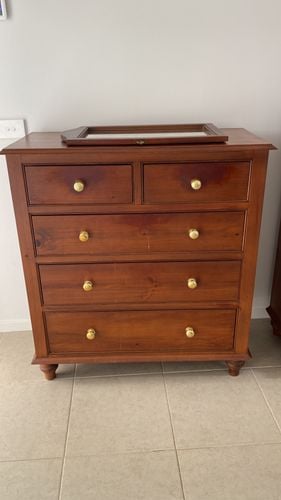

About to embark on my first upcycling project. I am going to sand the top and apply chalk paint the rest of the drawer. (The drawer is in its natural colour).
I watched so many you tube videos to see if I  need I to prime to prevent dark wood bleeding). But did not find much info.
Any advice would be appreciated. TIA

I understand your worry about old stains pushing through causing wood bleeding. This often happens with really dark-stained furniture or very old pieces that used shellac as a sealer. Your drawer cabinet does not seem to be that old and looks moderately stained. I suggest sanding it down to see if you can reach the timber base of the cabinet. You'll notice that once you reach the raw timber there should be none of the original colour left.
However, if after sanding through and you notice that there are stubborn patches of colour that will not go away, that is an indicator that you'll need to use a primer with a stain blocker. A good example would be Zinsser Stain Blocker. This primer is specially formulated to block stains from bleeding into the main coat of the paint.
