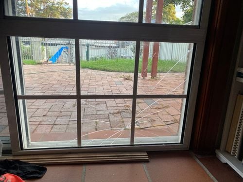

I have a broken window, only the lower panel is impacted.
Money is a bit tight, and I'd like to change it myself.
There are online videos to replace either the entire window, or remove the wood edges to access the glass.

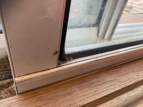

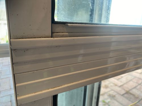

In my case, the frame is in aluminum, and I don't know how to remove them to access the glass.
Any indications would be very appreciated.

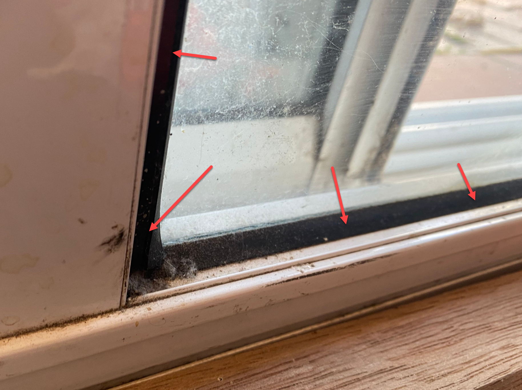

In aluminium framed windows, the glass is held in place by that black rubber that runs around the perimeter of the glass. This is known as glazing wedge, and it is a specialist product that is relative to the thickness of the pocket in the aluminium and the thickness of the glass.
The glass is set in the aluminium channel, on rubber blocks that keep it slightly above the bottom of the channel to prevent its corners and edges, which are the most vulnerable spots, from coming into contact with the aluminium.
The wedge is then pushed into place, holding the glass firm inside the channel.
