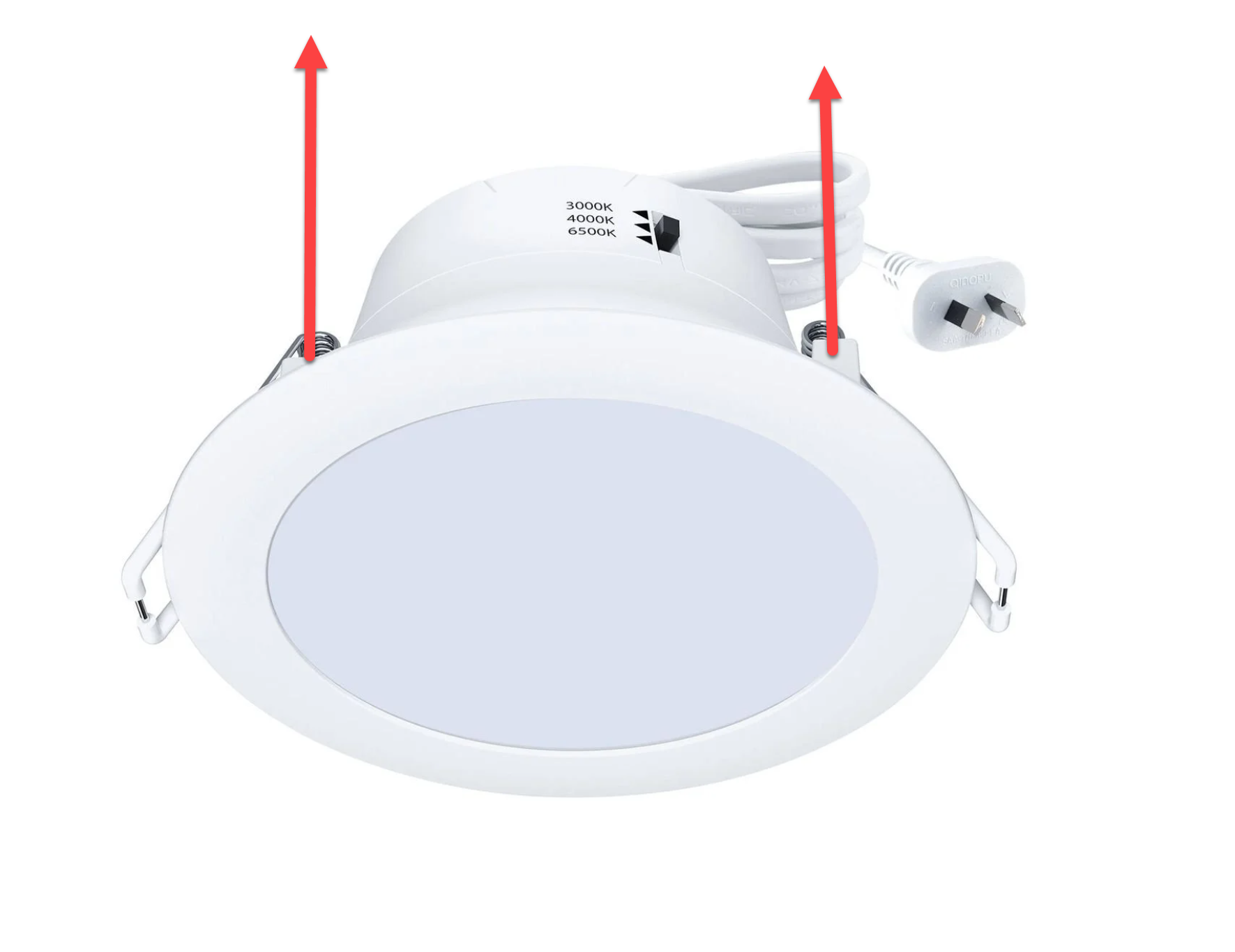

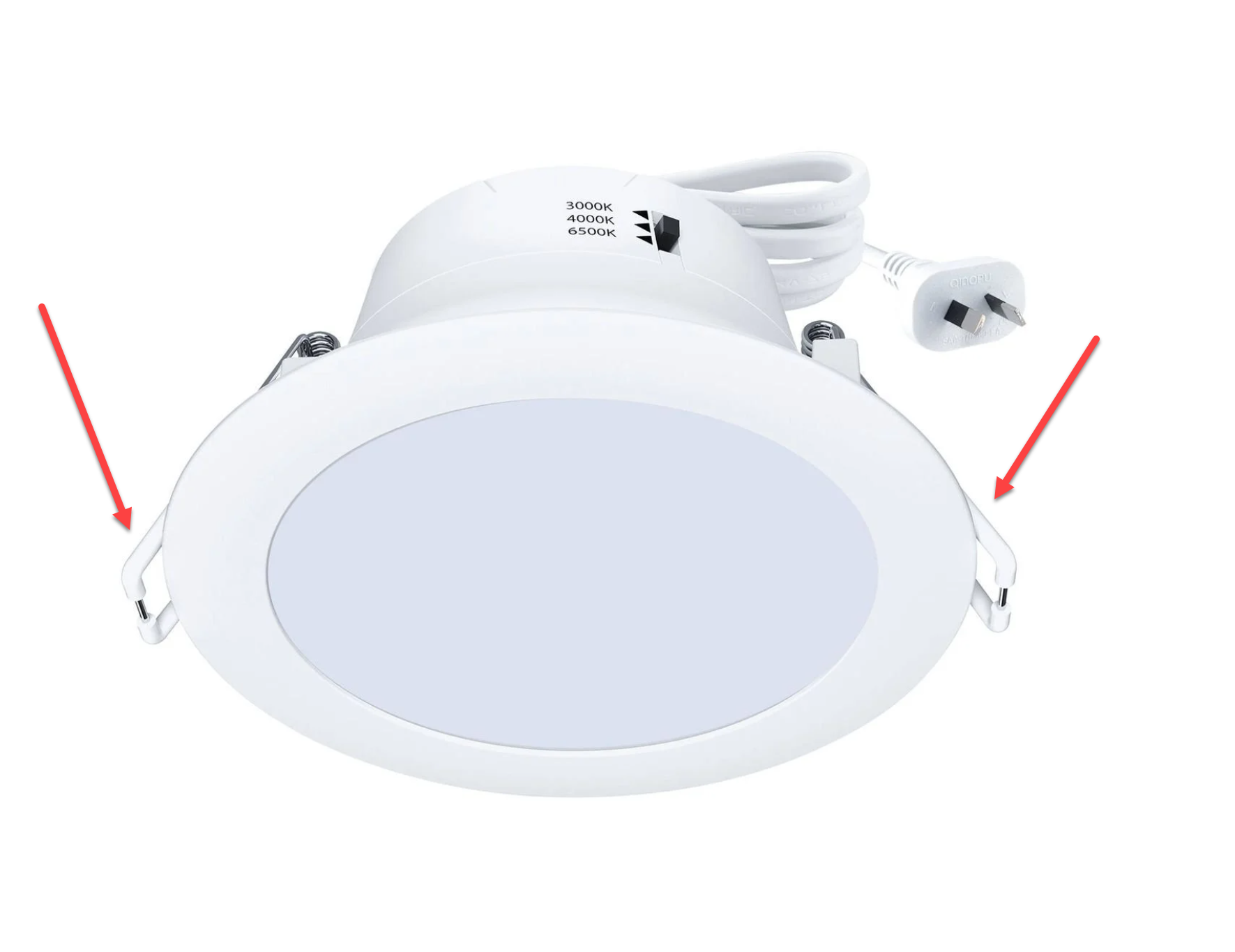

The way to remove them is to pull them straight down like you have been. The resistance you are feeling is two spring-loaded toggles that pull against the back of the plasterboard to hold the light fitting in place.
If you keep pulling gently, they will eventually aim straight up and the spring will make them push sideways into the plasterboard.
At this stage, you should be able to see them and can place your hand on them to stop them snapping back down, which is what can damage the plasterboard.
Once the light fitting is out, you can see whether it is a downlight with a plug, like the one I've shown above. If this is the case, you can replace them yourself. If they do not have a plug-in connector and you can see they are connected to a Downlight Transformer, then you'll have to contact an electrician for their assistance.
If they have a plug, you can replace them yourself; you will just have to match the diameter of the cutout in the ceiling. You can even bring the old downlight in store with you to match it up with a replacement.
