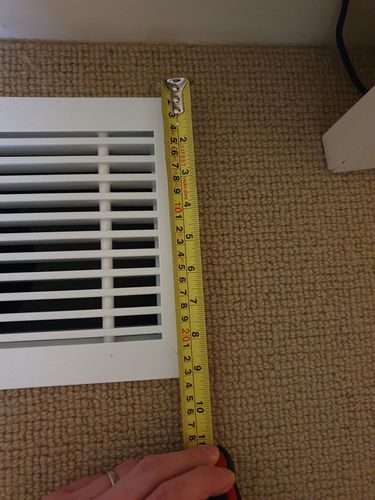

We have these floor vents in our three bedrooms for heating and cooling. I have a couple of questions on them.
They are great but I think would benefit from some deflectors. Just checking if the deflectors available at bunnings would fit these? Photos attached with dimensions.

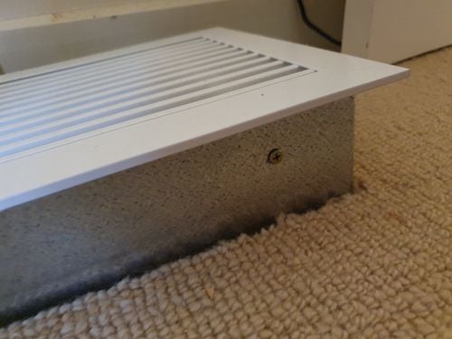

I also want to know how to take off the cover to clean the inside. Is it as simple as removing the screws that are on the side? (Photo also attached). The cover doesn't simply slide or come off like other wall vents might.

If the vent covers are not a press fit, then the next likely solution would be that those screws are retaining them. A couple of screws on the wall side might also need to be removed. A Trojan 38mm No.2 Phillips Screwdriver will be helpful in removing those screws due to its short length. When removing the vent cover you might expose some sharp tin on the ducting. Make sure to wear some gloves to protect your hands.
The Accord Heavy Duty Floor Vent Air Deflector is designed to suit either 10 x 30cm or 15 x 35cm vents, so it looks like your vent is too large for these deflectors. They would be fine for the depth of your vent as it has quite a large frame, but they aren't long enough as your vent appears to be around 50cm wide. Accord does do a large version that suits up to a 40cm wide vent. Still, that would only partially cover your vent cover and wouldn't be wide enough to sit on the frame of it.

I was looking to have the deflectors better direct air more into the room. Currently they do an OK job of pushing the air up but think the room temps would be improved with use of these deflectors.
