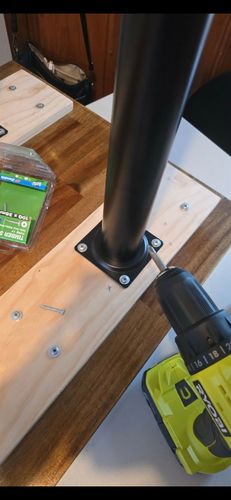

Hi all, I built a desk in November 24; and I am wanting to stabilise it/stop shaking; prevent sagging from a large monitor & stop the legs from ripping out when moved (as the desk is not thick enough to have longer screws for feet).

I have a piece of wood cut that I am thinking of gluing/clamping underneath where the legs are going; then redrilling whatever legs I go with; into them to provide more surface area so the screws are long enough not to pull off when the desk is moved and hopefully provide some stability. This may include mounting plates?

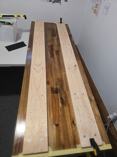

One effective solution is to add long braces along the underside of the desk. Instead of just adding short braces between the legs, use two longer pieces of timber, such as 140 mm by 19 mm pine, running the full length of the desk, one near the front edge and one near the back. Screw these in place with screws close to the combined thickness of the top and brace, roughly 37 mm, spacing them every 30 cm or so, and position the end screws so they do not interfere with where the legs will attach. This does two things. It adds extra thickness so you can use longer screws for the legs, helping them hold better, and it adds rigidity to the desktop to prevent sagging. I'd suggest these 35mm timber screws. As we have 37mm ensure you do not overdrive them into the pine timber as they could penetrate the top.
You can then reattach your legs with the longer 35mm screws.

Thank you so much for the insight. I will try the braces across the length of the desk. I was planning on glueing these first then screwing - but from your recommendations this isn't needed?
Also with the wood length - the desk is 1800, would the 1200 pine braces be fine?

Gluing and screwing would be preferable to screwing alone.
You could potentially use 1200mm pine, but then your legs would have to be 1200mm apart. I wouldn't suggest bringing the legs any closer together than they already are. You could have the 1800mm timber cut to 1500mm, so it doesn't extend right to the end of the table.
You would have to try the braces to see if they resolve your issue. I'm unsure whether the wobbling was caused by the shorter screws or by the legs themselves. I would first fix the legs, then determine whether the bracing is necessary.

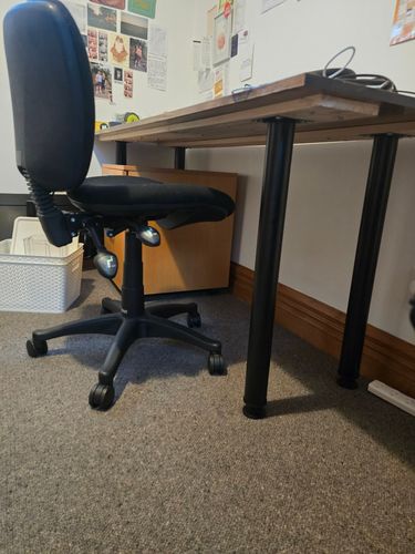

Hi Mitchell! Made some great progress! Braced as you said and changed the legs.
Added a lot more stability lengthwise and no more sagging.
But the instability front to back is still a major issue. Possibly due to the size of the desk vs legs and placement?

When you mention front-to-back instability, is this the table rocking @aleisha8099? If so, it's likely due to its thin depth from front to back. With additional weight on the table, it will help stabilise it.
Will that drawer be sitting under the table? You could use a couple of downpipe clips, or suitably sized half-saddles to attach the legs to the side of the drawer.
