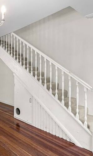

so I’m completely new to DIYing and any sort especially woodwork but I’m keen to start learning. I’ve been reading articles about under stair storage and like the idea of drawers under stairs.
 I like the idea of picture 1 and our current under stairs situation is picture 2. I’m not sure what the purpose of the hole in the door is either as it is empty inside.
any tips on how to even start or is this best left to the professionals?

I suggest having a quick look at these discussions - How to build in cupboards under staircase by @minnieS and Shoe shelves built into staircase by @den1ska along with How to build storage cupboards under stairs by @dannyrus. These should give you ideas on how you can build your storage under the staircase. For a first-time project it will be very challenging as there is a great deal to learn on the go. Generally, I would suggest a much easier project when starting out, such as a D.I.Y. timber plant stand by @joineryjo. Get yourself familiar with the tools and getting use to cutting wood.
If you can wait, I would suggest putting this project on hold and getting a few projects under your belt before you tackle this one. There is no reason you can't be the one to build this, you just need to gain some experience when it comes to building cabinetry.
Oh and in regards to the hole in the door, I suspect that the former owner had a pet and that was its residence.

Thats a great project idea, but I have to agree with @EricL that it would be quite a challenging one requiring a fair bit of experience and a range of tools. A mate of mine is also a novice and keen to learn and has signed up at a local TAFE to learn DIY type of woodworking.
I suspect that hole was maybe for a cat or dog with a bed inside.

Draws under the stairs would be pretty handy to have :smile: And yeah I would be think that the hole is for a pets "get away" from everyone type deal :smile:
Being a newbie You could start out with small parts  of the project and see how you feel with what you get done.

I do agree it may be a bit much for a first time and I do like your suggestion @Dave-1 of starting off small and doing parts before committing to the entire project.
Thank you all will reach out with other questions and at least that solves my question of the strange hole in the door 😂
