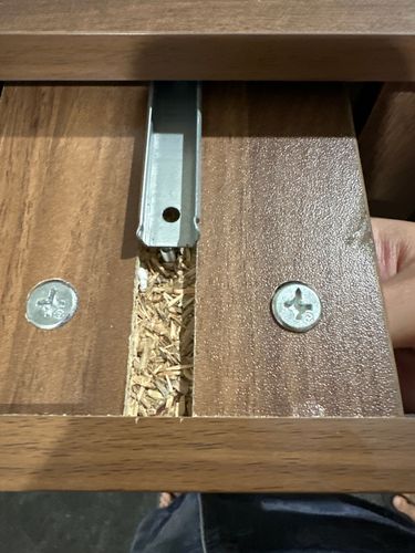

How to assemble Artiss Xavi Chest of 6 drawers as the screws aren’t of the right size and drawers can’t slide in

I'd be happy to help but I'm not 100% sure what the issue is.
It looks like the drawer slide is not long enough to reach the bolt coming through the chipboard. Is that correct?
It also looks like the connector cam on the right isn't sitting flush with the face of the chipboard. Is this also causing an issue?

Is there a chance that the drawer slide is flipped around the wrong way?
