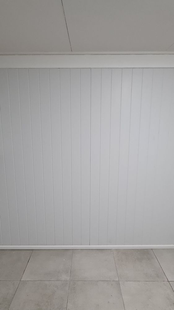

Just a quick follow up on this post for anyone else who decides to proceed with attaching the VJ panels directly to a brick wall.
I was able to complete this successfully - by using temporary screws to fix the panels to the mortar of the bricks while the construction adhesive set. Also built a temporary brace just to help hold the boards in place and apply even pressure during the setting process. All worked fine - boards set in place solid and without issue. Simply removed the screws, puttied and painted once set.
Was updating a dreary room as part of a larger renovation of the underneath section of the house which was formerly only partially built in. Couple of quick before and after pics below.

That looks fantastic, @Marshall!
As they say, "Necessity is the mother of invention". I can only imagine where we would be now if those first brave D.I.Y'ers decided not to take the risk of doing the job themselves.
Please keep us updated on your project and let us know if you have any issues with this installation. Any long-term feedback you could provide on your fixing method would be greatly appreciated.
