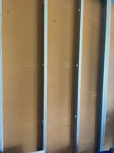

I have this blank wall that only has battens.
I want to attach VJ boards, how do I do this?

I would use these Plaster board Screws and cordless driver with a no 2 phillips screw driver tip. There maybe better screws avaliable.
Mark on the floor and roof where the start of the middle of the battens are so once the VJ board is up you can see from the external marks where the batton runs. so you can screw into the battons with out too much fuss. Between the two batton centre line marks drawn put in two screws and use astring line as a fixing gude. If the Vj board trysto crack best to pre drill the screw holes.

Welcome to the Bunnings Workshop community @emmajae. It's terrific to have you join us, and many thanks for your question about installing VJ panel.You might like start by reading through this guide on Installing Easycraft On To Steel Frames. Once you've read through the guide, let us know if you still have any questions which we can assist with.Mitchell

I am also wondering what should I use to cut the vj boards? I need to go around a door.

You should use a circular saw if your cuts will be exposed, or if you're using trim to cover the cuts, then you'll be able to use a jigsaw. It's harder to get a nice smooth cut with a jigsaw, so I'd only use one if you are adding trim over the cut to conceal it.
