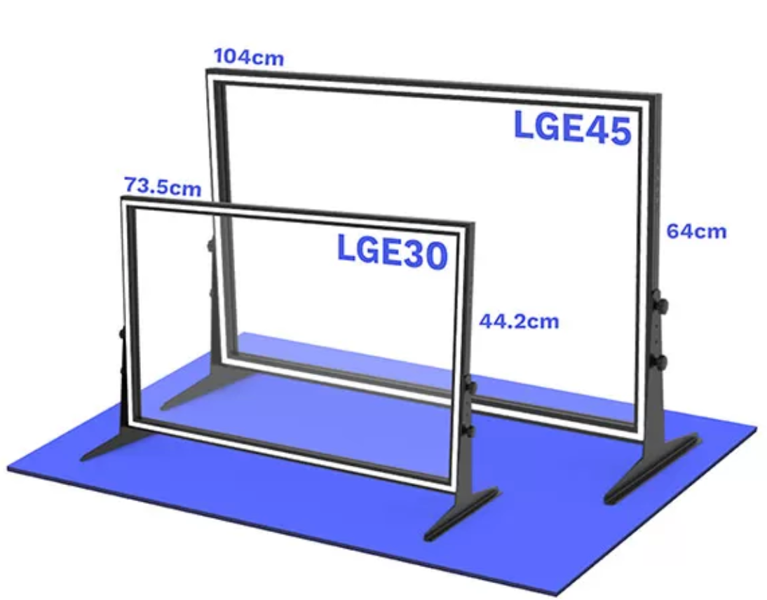

I am looking to may my own Lightboard as per the following youtube example ; https://www.youtube.com/watch?v=agsUU9i__hc
and this example - https://learningglass.eu/products-en/ic-lge/ Something that will fit on a normal desk for a Webcam, dont need the lights, just the Plastic glass and frame
I wanted to get some suggestion to the parts and to make the frame, probably can do it out of wood
