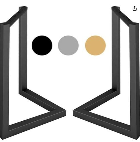

Now to the legs, you will need solid legs as it will weight a fair bit. You could build them yourself or even frame up a box for one end. I do prefer steel for this type of weight tho. and in particular I am thinking of the V styled footing and top of a support.
This type of shape. I couldnt find one like this in Bunnings tho. You would just need to make sure that the steel legs can carry a couple of hundred kilos (thick timber bench plus the stone)
