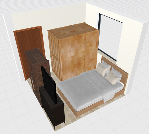

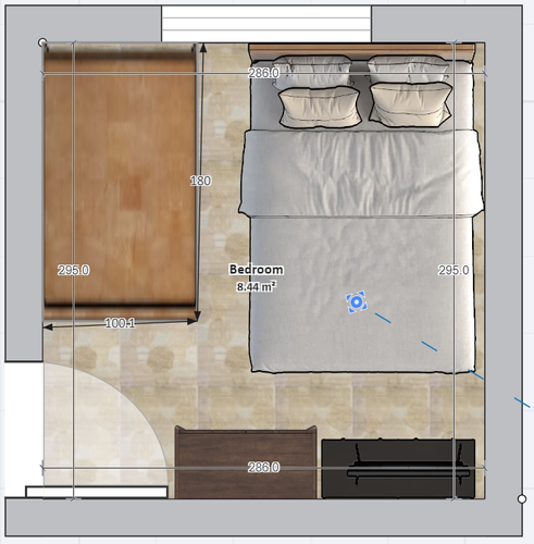

Hi! At my current place I've been using a wardrobe as a vocal booth (voice acting/voice over), and shortly I'll be moving to a house without such a space. I've done a mock up of what little room I'm working with, and was looking for help working out what materials to use for my new booth! (Yes I'm aware that the room will be crowded to hell, but I am unable to relocate the cupboard to another room in the house so it is what it is).
I'm estimating the booth to be around 100cmx180cm so it's big enough to fit my adjustable desk in, as well as an office chair, ring light and acoustic egg foam panels. Height I am unsure, but I am 164cm tall so just needs to be higher than that so I can stand comfortably. I don't think this booth will need a floor, as the bedroom is carpeted.
The desk is 60x80cm. The chair might be 70cmx60cm? and needs some room to lean back a bit. I have 24 acoustic panels, but might need to purchase more (and don't have any bass traps yet). The ring light is on a stand, but would only need a few cms (maybe five) to squeeze in behind the desk.
I'd need a small hole cut out maybe near the bottom (closest to the window) so I can run an extension cord through... And I'm thinking a door would be better than just a moving blanket. Yes, that means I will absolutely die in the South Australian summer lmao but better for sound proofing.
My budget is probably around $300-$600 (because I have to buy the chair), but potentially could go a little higher if materials dictated so. I'm aware that building something under $2,000 is not going to result in super professional quality/be completely sound proof, but I am starting out and probably going to be in this space for a year and a half, give or take, so not going to invest heavily until I have a permanent home base.

I'd recommend you build your booth from CUSTOMwood 18 x 2400 x 1200mm Raw E0 MDF. It's quite dense, and its thickness will allow you to get away without having to build a solid timber frame. You'll need around six panels, bringing you to the $300 mark. You'll need some timber screws and a few hinges for your door.
Each side (being the longer ones) is constructed from an 1800 x 1200mm and 1800 x 600mm panel to give you 1800 x 1800mm. Some mending plates and small screws can be used to join these large side panels. The front and back are constructed from a 1800 x 1000mm panel. The top is constructed from a 1850 x 1000mm panel.
For the door, you might like to cut off the top 200mm of it and screw it into position to help reinforce the top and structure.
I've created some renderings below to assist you with your project.
With the sizes of the panels I've listed, you should be able to screw through the edges of the boards into the thickness of the adjoining board. Make sure to pre-drill your holes first with a 3mm drill bit to avoid splitting the panels.
