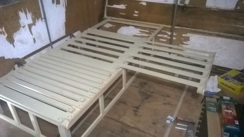

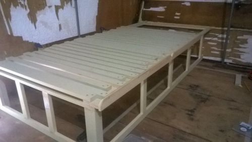

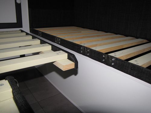

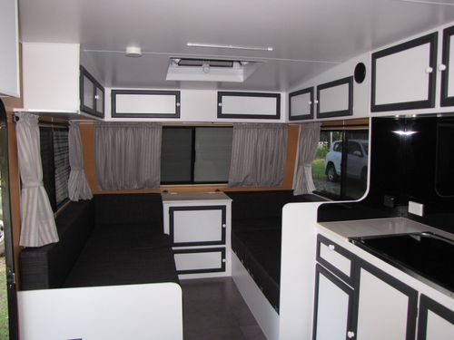

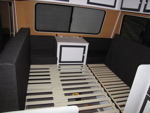

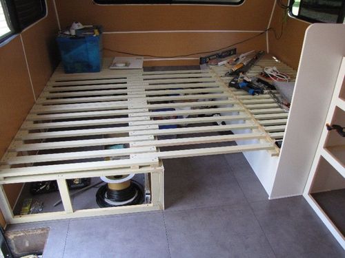

Hi @carolbradford1 when I did my first caravan reno, I wanted 2 single beds at the front but to also allow it to become a double bed should the need arise. I followed instructions from Deep Red Motorhome's build here and modified them to suit my needs. I hope the below images help as something similar could be achieved with a corner lounge.
Kind regards
Shelley
I built a single bed base with the sliding top following Deep Red's instructions There are 2 sections to reduce the weight as both are hinged for access to storage underneath. I then built a second bed opposite with just a plain slat top, also hinged for access underneath.. I finished all the cabinetry off with 3mm poly coated ply to keep the weight down. The cushions were made from a foam queen size mattress from Fantastic Furniture which I cut up and covered with upholstery fabric. The slats slide across to the other bed. With interlocking furniture connectors (ebay) to hold them up. The cushions re-arrange to form an east-west double bed.
