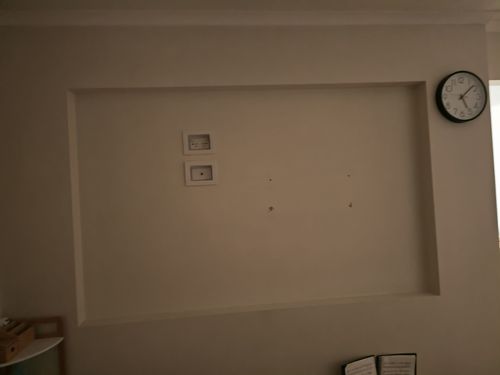

Oh appreciate your post! I love all your projects btw! Could I ask if you have any idea how to attach this metal sheet to a living room wall? I checked that metal sheet in store but it feels heavy for me lol, couldn't hold it with one hand, my concern is that will drop from the wall and hurt the toddler, not sure if I found the correct product though. Could I have your advice? Thank you so much!
Or would that be safer/easier if I just paint with this?
White Knight Rust Guard Medium Grey Metal Primer Paint - 1L
But would that work that same with the metal sheet?
I wanted to make this entire rectangle TV area black and magnetic☺️ so no TV anymore lol! Just imagination for my little ones😆
Appreciate your reply in advance!

Hi @DonNorman,
That sheet is 3kg, so not overly heavy, but not light. What's the living room wall made of? Those details will help us guide you to the correct attachment product.
You could likely predrill at least the four corners of the sheets and then fix them to the plasterboard with Wallmates or masonry with wall plugs.
Ensuring it is secured well is important; that's why I would probably fix the sheet with screws to the wall, then also come back, like in the guide, and fix a timber frame around the edges.
