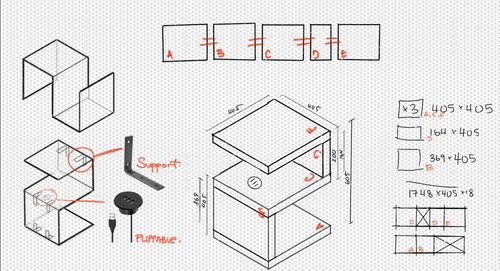

I’m trying to make a side table that can hold my vinyl records and also act as my bedside table. The vinyls will be on the bottom shelf and my everyday items will be on the top shelves. These are my expected plans for construction.
I’m trying to figure out what the best and most stable way of putting it all together. I was initially going to just put pocket holes to put it together but I’m worried the structural integrity wont be strong enough. Then I thought about using angled brackets but I’m not too fond of having exposed hardware.
