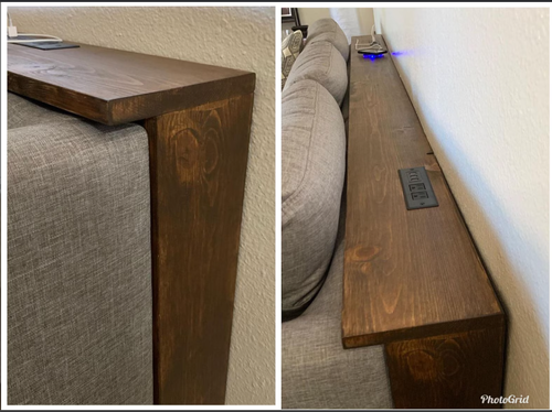

Hi, I want to make a really narrow table to sit behind the sofa. Similar to the image below. It would just be for drinks etc. Needs to be about 90cm high, 300cm wide and I'm thinking about 20cm deep. I don't have many tools and live in an apartment, so looking for a design with minimal construction required! I was thinking of using a couple of lengths of pine for the top and 2-3 90cm pieces as 'legs'. It doesn't need to be free standing as it will be wedged between the sofa and the wall. I could possibly wall mount it too (although the walls are concrete so I'd rather not!).
 As it needs to be fairly long, looking for ideas on the best way to join the 'top' pieces. Any other advice also welcome! Thanks in advance.

Due to the length of the table, I'd suggest speaking to the team at the Trade Desk and ordering a 3m length of 235 x 19mm DAR Pine for the top of the table. This would erase the need for any form of joining for the top.
You could then use the same profile of timber for the uprights, or you could use 184 x 19mm DAR Pine for the legs to have the overhang like in your inspiration images.
Please see the below render as an example of how I propose you construct this so that all the materials are in line with our cutting policies and can be cut in store and simply screwed together.
This design uses a 3-metre length of the 235 x 19 pine, as well as 5.6 lineal metres of the 184 x 19mm pine.
Note the two shelves at the base of the structure. These are to horizontally brace the uprights 100mm up from the ground to prevent the legs from racking and instability.
To connect everything together, I propose using 2 x Zenith 10 - 8 x 50mm Galvanised Countersunk Rib Head Timber Screws at every connection point.
This will require you to use a drill to predrill pilots and then install the screws. I would suggest using a Sutton Tools 3mm Viper Jobber Drill Bit to predrill holes for the screws and then to countersink the holes with a Craftright 3 Piece Countersink Bit Set
You can then paint or coat the timber to your liking. My suggestion would be a stain and varnish such as this Bondall 250ml Walnut Monocel Stain And Varnish
Also, allow me to tag some of our knowledgeable members to see if they have any advice or design ideas, @Nailbag, @Dave-1, @Herrenovacation, @RenoRach.
Let me know what you think and if you would like further advice, clarification or alterations to my above design, please don't hesitate to ask.

I like your idea :smile: Very handy thing to have for sure!
I also like @JacobZ 's mock up of the design and the use of pine DAR, It will make it lighter and easier to work with then the Option I was going to suggest.
Option 2 (I think the first option is better but just to add to the choices for you)
I was going to suggest to make a frame up using 70 x 35mm Framing MGP10 Untreated Pine 2.4m (A large rectangulat frame with a vertical piece in the middle to stop any flexing) pretty much along the lines of JacobZ's suggestion and then using 140 x 19mm 5.7m SpecRite Merbau Joined Set Length Pre-Oiled Decking (I am pretty sure it comers in shorter lengths but width wise was what I was after) To actually give it a nice face look On three sides. The bottom can just stay the pine Framing..

Hi @LuLu2 I think the design that @JacobZ has provided is a perfect solution. My only suggestion would be to consider an all in one pilot hole and countersinking bit.
