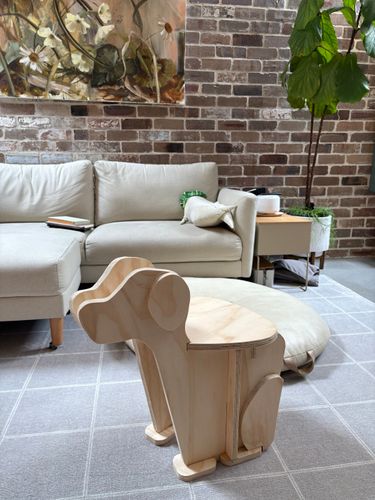

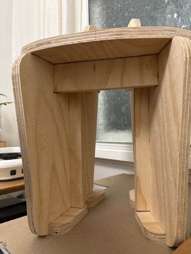

I am building a stool out of 18mm plywood and would like ideas on how to make it more structurally stable.
I own a jigsaw, drill, random orbital sander, clamps, wood chisel, japanese wood plane, but no table saw or jig for super straight edges and complicated joins.
I have read that I should carve a shallow dado on the underside of the seat, but I am not confident. I am considering adding a corner block. Any advice here? I am a beginner.picture of chairpicture of chairUnderwise from the back. not there are small gaps due to me not cutting 100% straightUnderwise from the back. not there are small gaps due to me not cutting 100% straightholding a potential corner block for reinforcing the jointholding a potential corner block for reinforcing the joint

Thanks everyone! I went with the stretcher idea in the end.

Looks good :smile: And really like the overall design!
