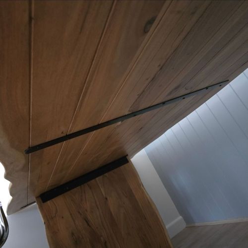

Hello,
I'm planning on making a wall mounted dining table. I will buy a slab ~ 160cm x 60cm x 4cm. I want to mount it on the wall using a foldable wall mount bracket. Was wondering what type of bracket would I need and if there's actually a bracket that will hold the weight of a slab plus whatever I put on the table?
I added a photo or a similar thing I want to make.

Thank you for your quick reply.
We actually want to mount it on our kitchen cabinet. I have added the photo. Not completely sure but I think it's timber.
We want to get rid of our huge table and add it it's spot so the kiddos have more room to run and so they stop hitting their heads on the edge of the table.
Do you think it will hold?
Hi @Kathy88,
If there is timber framing behind the VJ board, then it would be fine, but if there is only MDF or chipboard, which I suspect is the case, then you would struggle. The materials used in cabinets are not the strongest structurally. You would likely find that over time, with the weight of the table, anything sat on the table and having elbows resting on the outside edge, the screws will begin to pull out.
You could add some 70 x 35mm Framing inside the back of the cabinets, and then screw the brackets to that?
Or you could build a small stud frame on the outside of the cabinet, reclad it with VJ board and then screw through it into the frame.
Unfortunately, without some reinforcement, you wouldn't be able to install your folding table here.
Let me know what you think, and if you have further questions, please don't hesitate to ask.

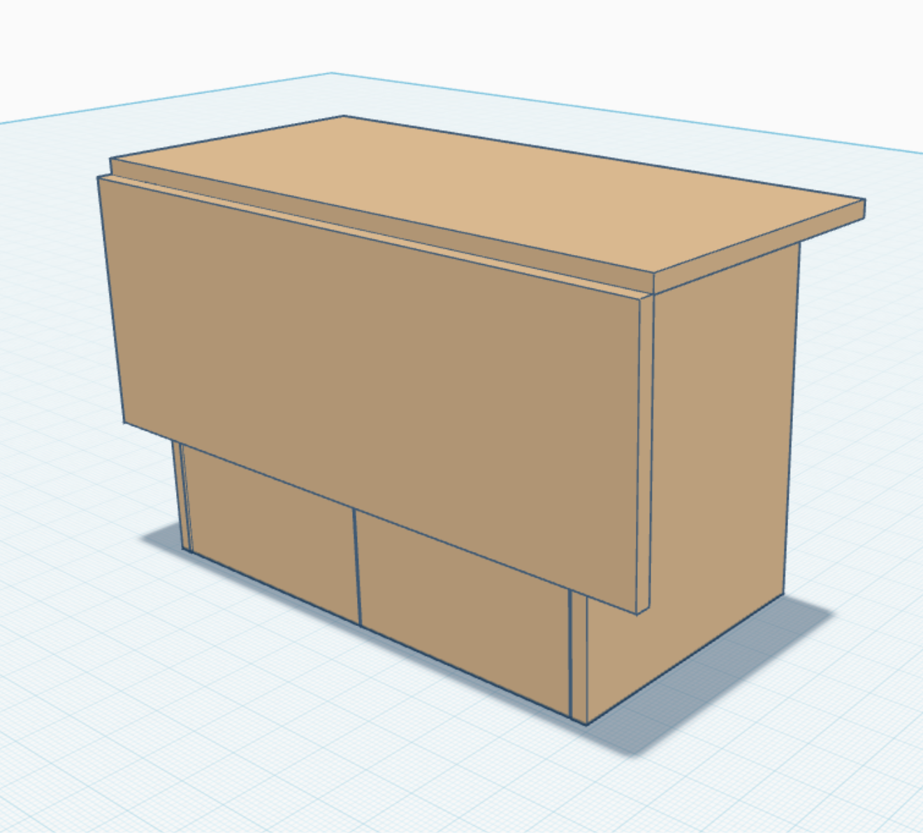

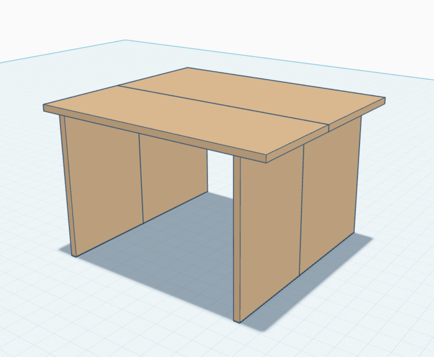

Hi @Kathy88,
Were you thinking of something like the rendering images I've created below?
Typically, piano hinges would be used for the folding legs and top.

Yes, this is similar to what I had in mind but the legs fold in too. Similar to this: https://pin.it/64v6rFDOi link is from Pintress. Because it's live edge, I want it fold down like what you have, not like to Pintress link. But if it won't hold if I have it cut in half then it might look weird and your design might be logical.
