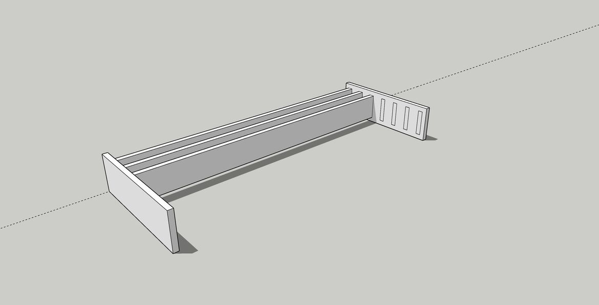

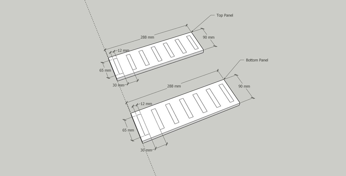

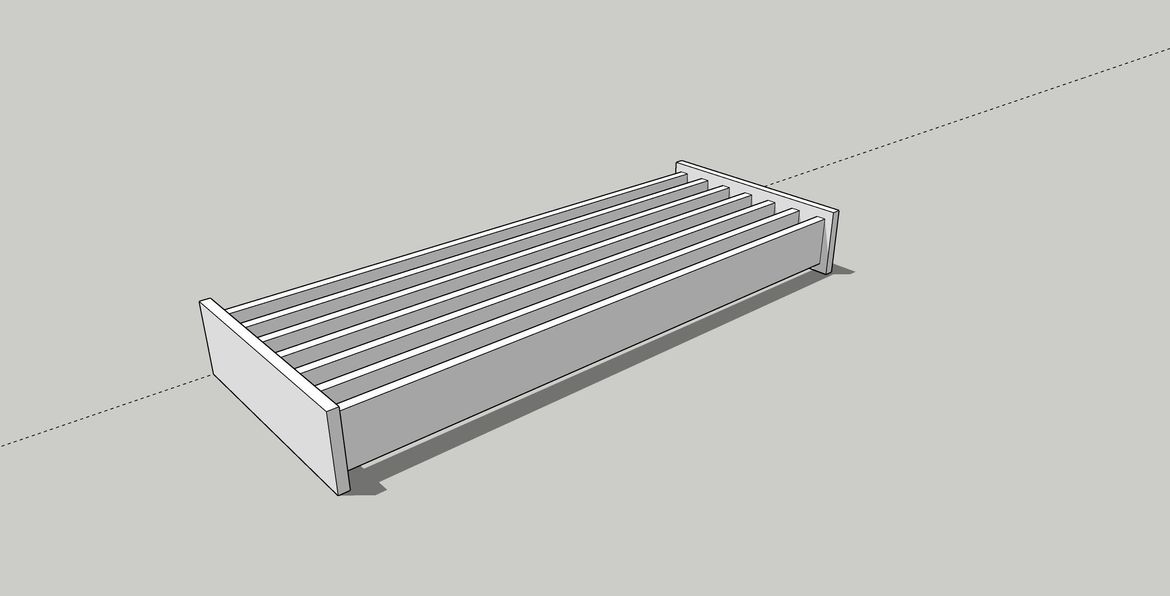

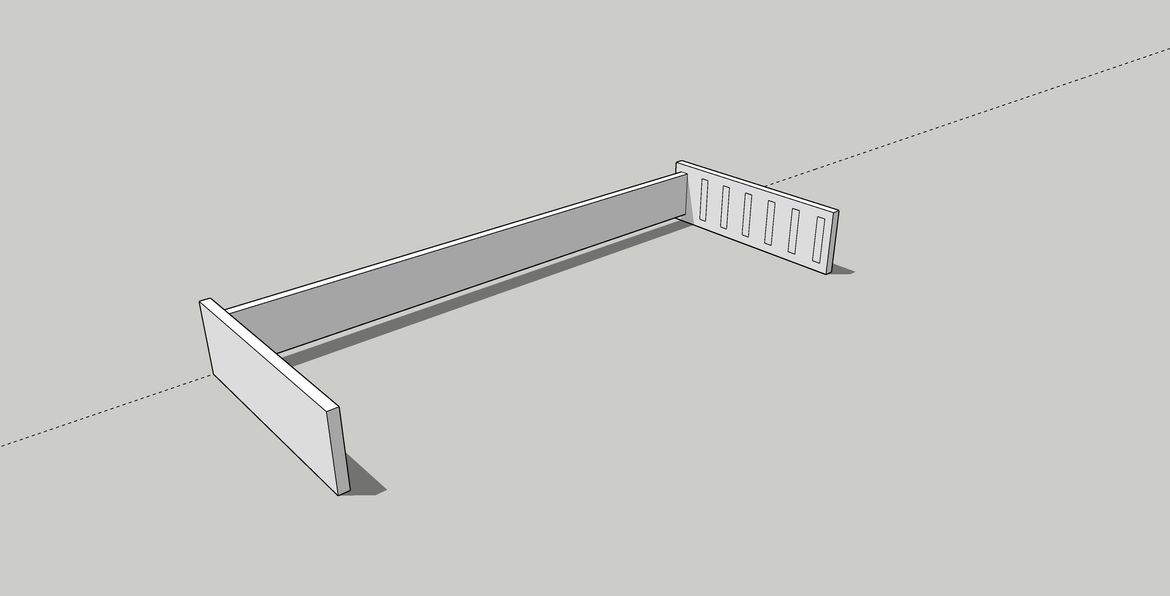

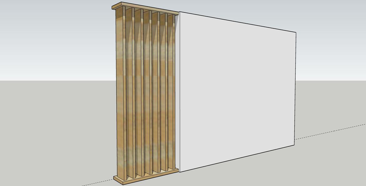

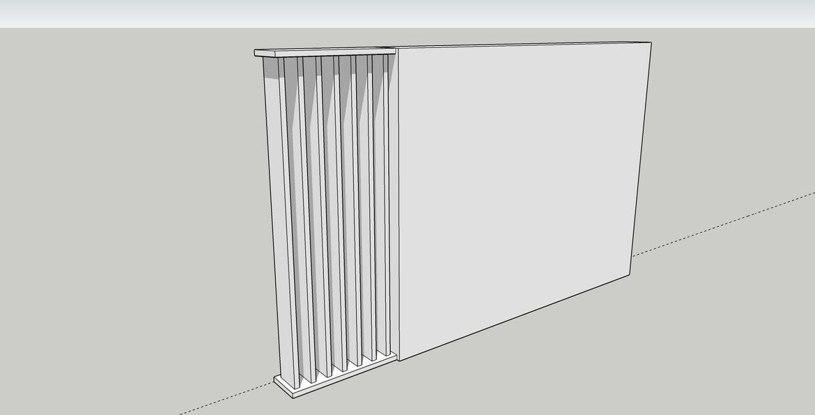

Here are the drawings along with the steps as promised.
