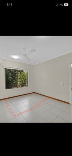

Hi everyone,
I’m looking for some advice on building a floor bed for my toddler.
We’re planning to place the bed in a corner and use two walls as two sides/edges of the bed.
Has anyone done this before?
  • What kind of frame or support works best?
  • Any safety considerations I should keep in mind (ventilation, gaps, wall protection, etc.)?
  • Would you recommend a DIY build or a specific product/design?
Photos or tips would be greatly appreciated. Thanks in advance!

However, if you are keen to build it from scratch, can you please tell us how big the bed will be? Can you please tell us more about the two sides you were referring to? Will the bed be integrated into the wall and non-movable?
If you have a picture of the bed you would like to emulate or a bed that inspired you, please make sure to share it with community.
