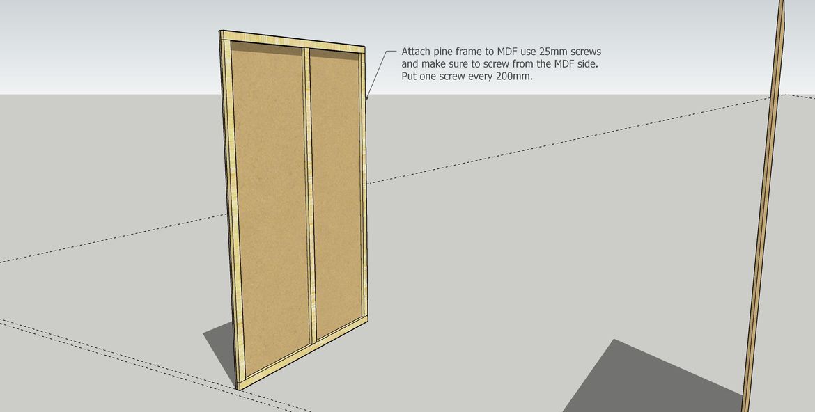

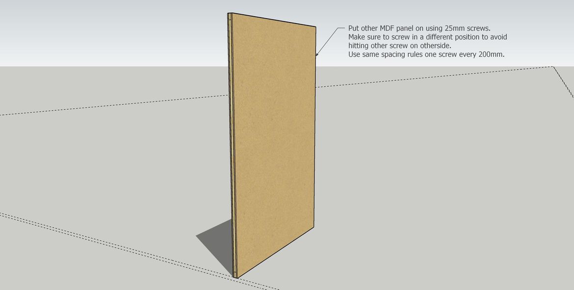

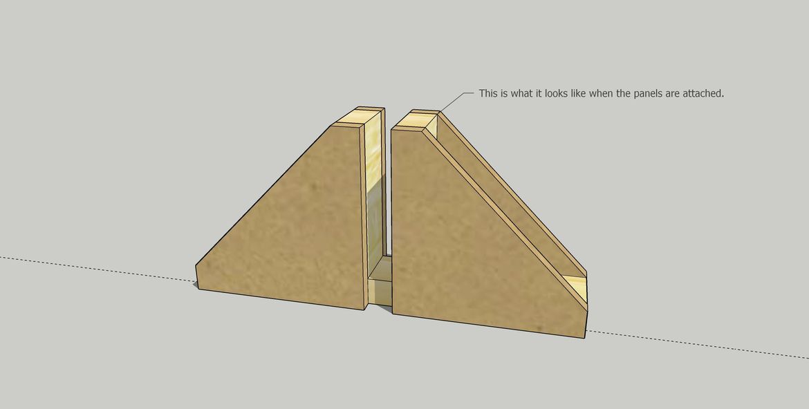

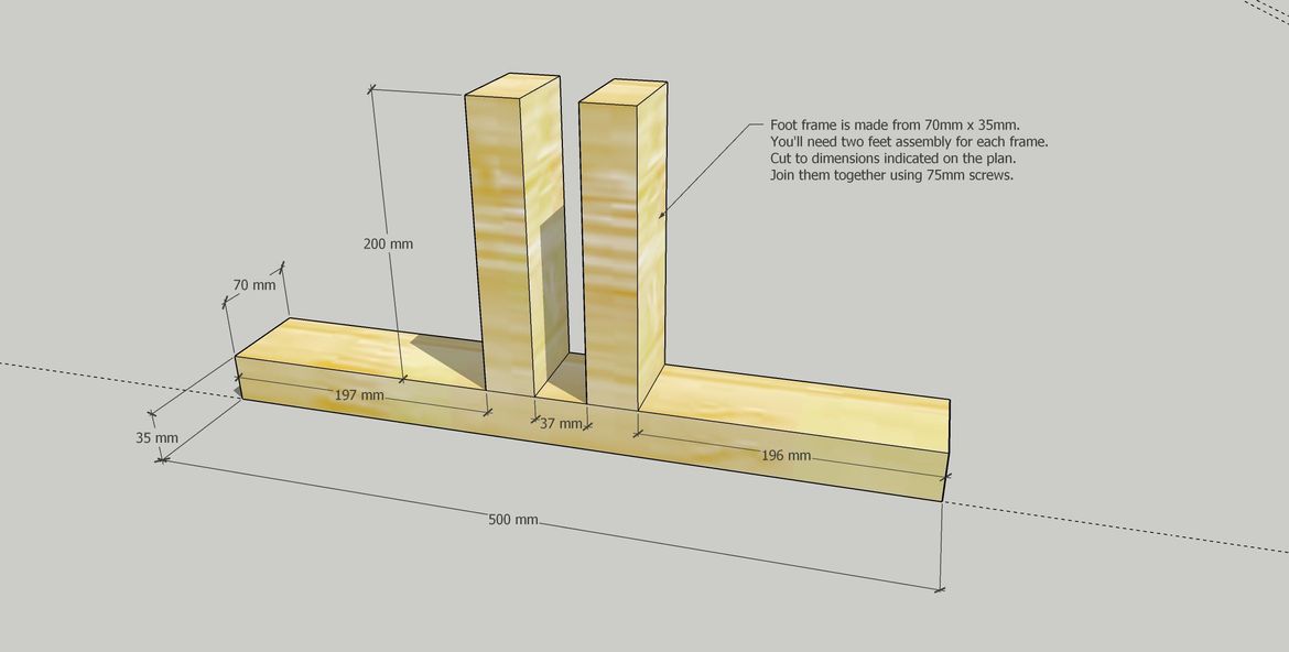

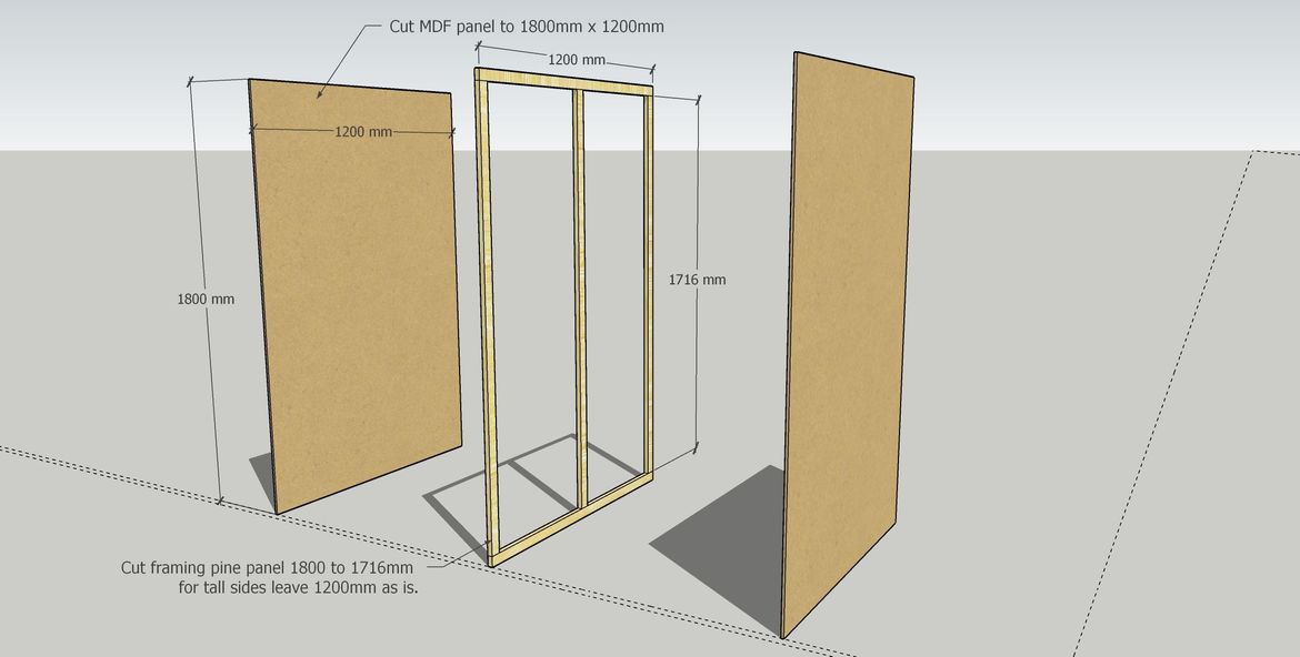

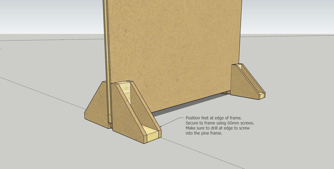

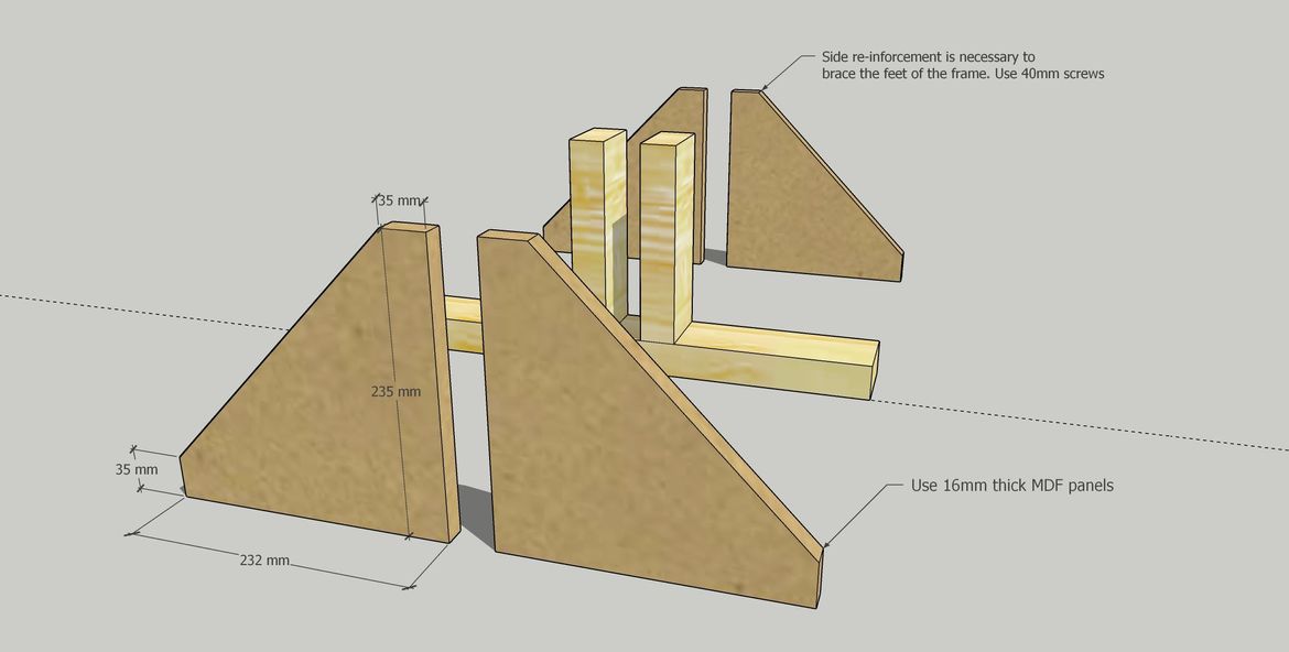

Hello,
I need to buy or make 4 x freestanding double sided walls for hanging and display of picture frames for our small exhibition space.
Approximate dimensions would be 1200mm wide by 1800mm high.
Can anyone get me started with the materials required and instructions to successfully complete this project.
Thank you,
Leah
Re: How to build freestanding walls for hanging pictures?
Hello @LeahBlacker
Thank you for sharing your question about how to build free-standing walls for hanging pictures. I've placed a suggested plan below for you to have a look at. If you have any questions about its assembly please let me know.
Tools needed:
  • Circular saw
  • Cordless Drill
  • Assorted Drill bits and screw bit
  • Measuring tape and pencil
  • Builders square ruler.
Materials:
LeahBlacker picture frame1.jpgLeahBlacker picture frame2.jpgLeahBlacker picture frame3.jpgLeahBlacker picture frame4.jpgLeahBlacker picture frame5.jpgLeahBlacker picture frame6.jpgLeahBlacker picture frame7.jpgLeahBlacker picture frame8.jpg

Hi Eric,
Thank you so much for your reply, it is very helpful and much appreciated.
