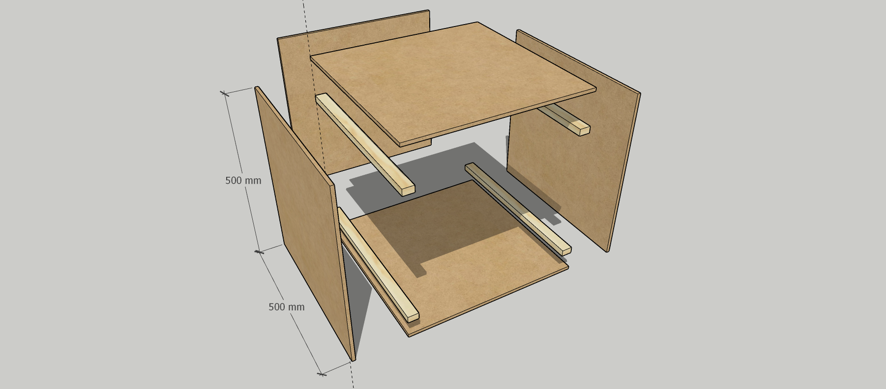

Hello @Kemcg3
I propose looking at the following:
Now that you have the proper tools, you'll be able to drill pilot holes which will prevent the timber from splitting. I understand that you are not keen on pre-drilling, but this will save you a lot of heartache and prevent your timber materials from splitting apart. I suggest using Zenith 8G x 25mm Gold Countersunk Rib Head Chipboard Screws - 100 Pack to anchor all the timber pieces together. This is on the condition that you'll be using the suggested timber pieces. Most importantly don't forget to use the PVA glue as suggested by Mitch.
My best advice is to measure and mark with a pencil every piece you are about to cut. Assemble the box in your mind and how the pieces will go together. Once you have built the first one, the following sets can be adjusted in shape and size, you'll pretty soon have all the custom boxes you'll need. I've placed an image below as a general guide.
