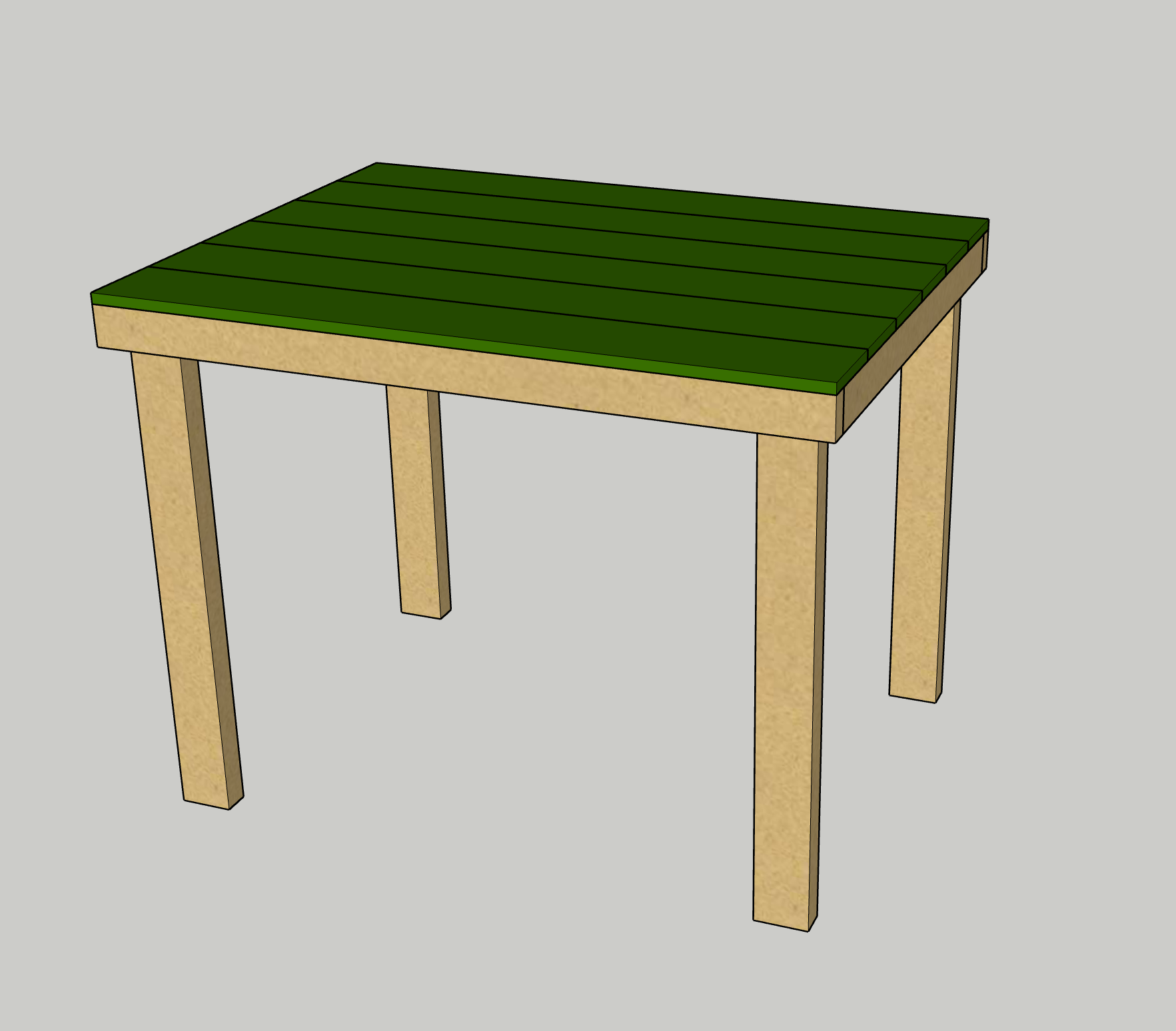

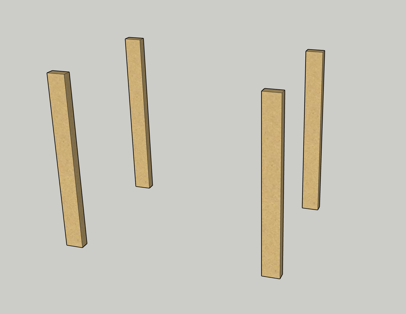

A table would need to start with some legs. You can use a wide variety of materials, but I would suggest using something structurally rated, such as a 90x90 post or some 90 x 45mm Untreated MGP10 Framing Pine.

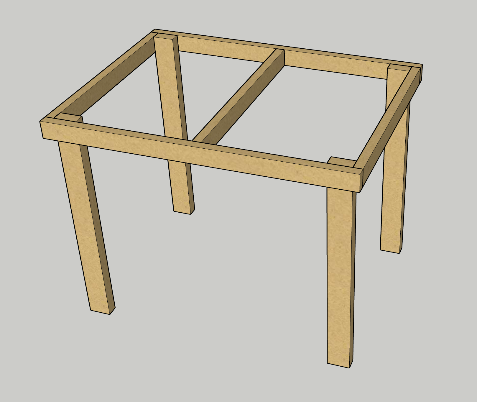

You would then need to create a frame to attach your floorboards to. You could use 70 x 35mm Untreated MGP10 Framing Pine to create a simple frame.
You could then attach your floorboards to the top of the frame.
