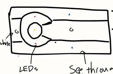

Essentially, I want to build a shelf/desk tidy that's shaped like the flag of Colorado.
Here's a sketch of what I was thinking. Imagine that the black lines are the wood planks and segments. The coloured dots are just to keep track of what colour each segment will be, whether this is done with LEDs or paint when I get to it.
So all I want to know is: what would be the best type of wood for making something like this? Also, would I need to do any finishing or varnishing for a shelf, or for the chosen wood specifically?

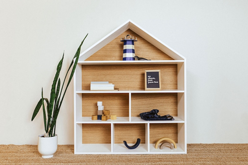

To explain this a bit better, take this photo of a house-shaped shelf/bookshelf.
Do you see how each segment is a space that something can be put inside? I want to do the same thing, but with the segments of the flag of Colorado. However, your sketch is useful for realising which segments would be where. For example, the two white stripes, and each of the blue stripes, would be their own shelf space. Then, to the left of the centre, there would be a circular shelf space and a C-shaped shelf space. When this is looked at as a whole, it would look like the flag of Colorado. That's why I had a width measurement as well: how far these shelves would extend from the backboard.

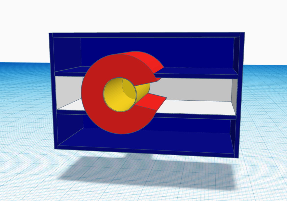

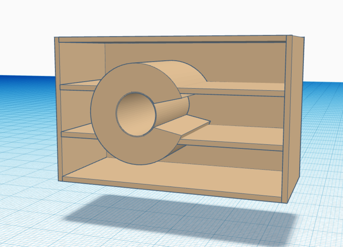

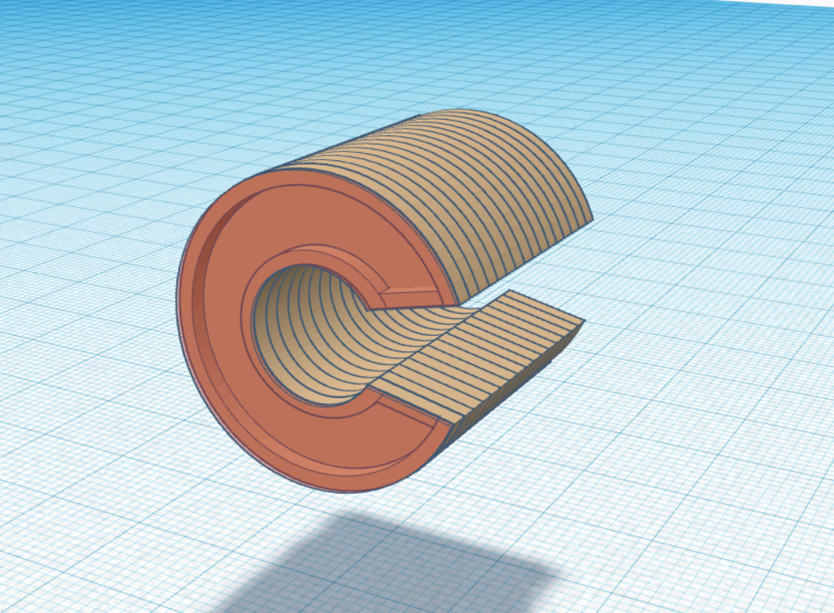

It sounds like you might like to create something like the rendering I put together for your below. The 3D effect on the C is fantastic in the first couple of renders, but it will be quite difficult to create the walls of the C. The last render shows a compromise where you'd only need to cut out a thick C from timber. You could cut multiple C's and stack them on each other to give you the needed thickness and deep 3D effect. I suggest using a piece of 90mm PVC pipe for the central area.
I'd suggest starting by creating the outside carcass and the C. You'll then be able to position the C within the carcasses and work out the lengths of the shelves and their adjoining angle to the C.
To light up the C, I suggest cutting all your templates and then taking one for the front and routing out the interior of it so it's just the frame of a C. You can then install your LEDs and wiring and cut a piece of red perspex to be mounted on the front.
I see no reason why you can't use 12mm MDF for this project, and a couple of sheets of 2400 x 1200mm 12mm MDF Panel Standard should be more than enough. You might even be able to do it with one. Ensure you give it a good couple of coats of undercoat before painting.
