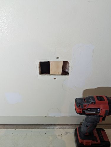

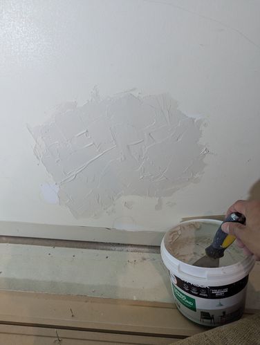

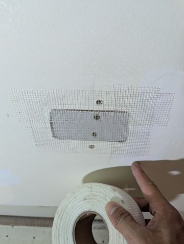

Thanks everyone for your replies, they are immensely helpful.
I've electrical taped the foxtail connections and push them back into the wall.
And then they've followed the instructions on the Bunnings website and patch the walls up with timber backing, plasterboard cutout, joint type, and topping compound.

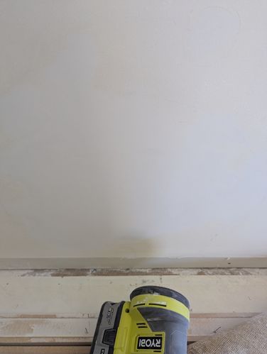

Here are some photos of the result. Thank you all.
Re: How to cover a old Foxtel outlet?
@bennib0i, you've done a fantastic job! From the photos, you really can’t even tell where the damage was. Well done and thanks for sharing your results.
