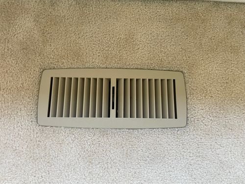

My house is on stumps and has a gas heater vent on floor. I’m planning to decommission the gas heater and replace them with individual split ACs on all rooms.

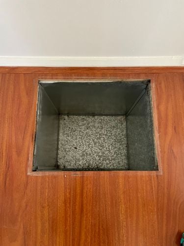

but I don’t want to keep the floor vents. I’m planning to remove the current laminate and carpet coverings and put hybrid flooring throughout. But how would I cover these vents? What should I do to these to keep them stable once I put the hybrid flooring on top of it?

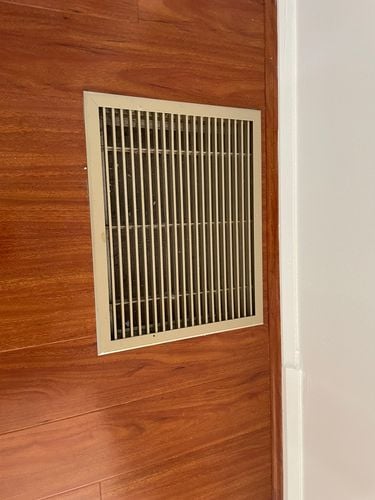

each of the vents in all the rooms are 30cm x 10cm and the hallway has the inlet vent which is 45cm x 36cm.

The vent housing will need to be removed and timber framing will need to be built around the hole. A timber panel will then need to be placed over the frame and the sides properly sealed to the existing flooring. A thin timber panel will need to be used over the patch so that it will be at the same level as the existing flooring. You can then lay the hybrid flooring over this area without worrying about it being weak or dangerous.
