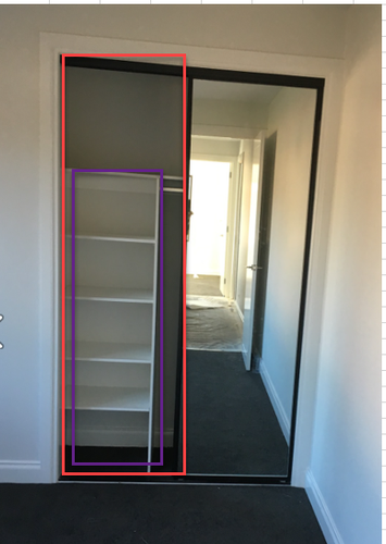

I have found some perfect pictures of what I am trying to do. Following are the images.

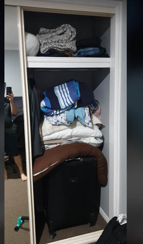

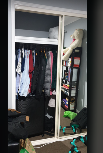

Following are images from my house ( Please ignore the mess, this is what I want to sort out

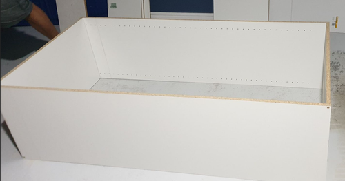

I visited my local bunnings warehouse to get standard Melamine boards and Predrilled side panels. I have found them and I have to customize them ( cut to fit my wardrobe). I have two questions, hope you can help me with that.
1.) I would like to use back panels as this is going to be a wardrobe insert, please suggest to me what Bunning products I can use for the back panel as shown in the picture.
2.) How can I join ( put ) the top and bottom shelves to the two vertical predrilled side panels? I believe I need to use screws to connect them to the vertical side panels. Please see the posted image.
Thank you for your help.
Typically, you'd nail a 3mm Melamine White MDF skin onto the back of the unit @Sugar. These Paslode 20 x 1.6mm 100g Bright Steel Flat Head Nails will be suitable.
When assembling, you should pre-drill and countersink the side panels and pre-drill the top and bottom sections ready to accept Zenith 8G x 40mm Countersunk Rib Head Chipboard Screws. Once you've fixed the top and bottom in place, you can cover the screws with Kaboodle Stick On Kitchen Screw Caps. I've added a rendering below to illustrate.

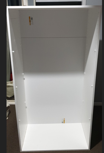

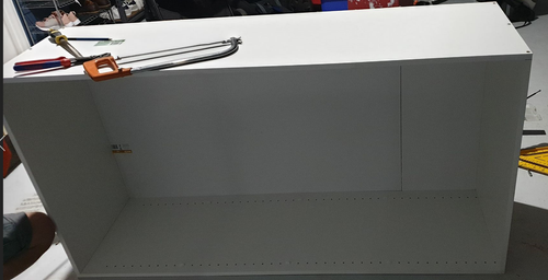

The followings are my result:
It perfectly fits under the wardrobe. it has enough space.
The size of this design is : 1500(H) X 782(W) X 445(D)
I wanted to make as big as possible so that it could fit under the wardrobe.
Process: I bought Melamine boards as instructed by @MitchellMc in previous notifications. Plus, the MDF backboard, which I did not get the right size, and hence I had to cut to the right size to fit on the back.
Precautions: While cutting the Melamine boards, it is very important to note if the edges are following 90 deg. I found that my shelves were not equally cut and later I found that the white Melamine ( predrilled and normal) boards were not cut perfectly in 90 degree when getting from the warehouse. However, there was not much difference and I could still manage to insert them and did some sanding to make even. I learnt this lesson. It will be easier for me to design next time. I learn few other things ( and my dad also) like how to cut withing damaging the surface while designing this.
The Good part: This can be taken wherever I will go. Not mounted to the house.
