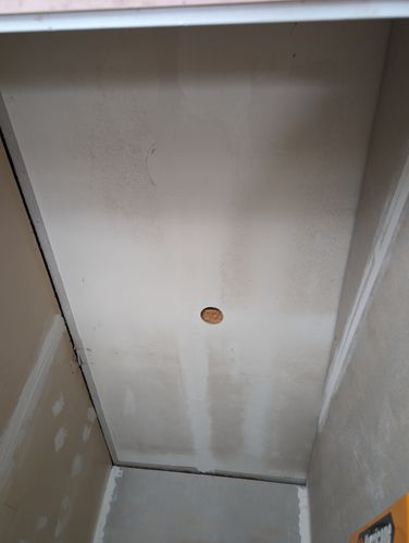

Hi my partner is trying to cut cornice at an angle to meet in the corner can anybody give us some advice on how to cut it please & thank you

Hi Mitchell thank you the dilema is we have a pitched roof at maybe a 45 degree angle
You might like to check out this discussion, @kyliekeith: How to make cornice corner joints with a raked ceiling. You'll likely need to use the mitre template to get an approximate angle and then do a test fit. After doing the test fit with the standard angle, you'll be able to see whether you need to increase or decrease the angle of the cut. Remember, you'll be filling any gaps with plaster, so the fit doesn't need to be perfectly exact.Mitchell
