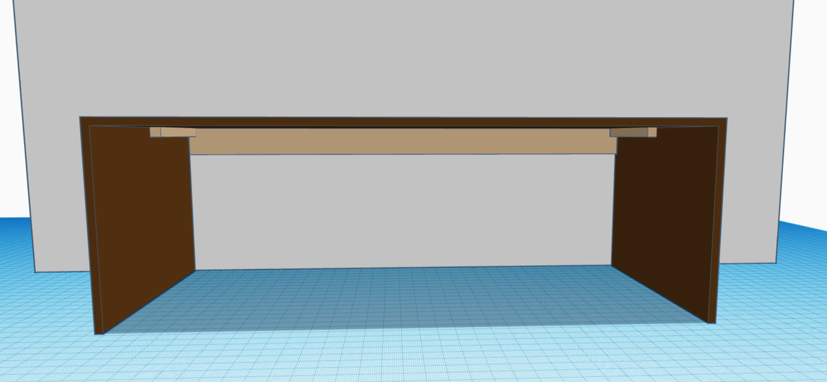

Another option is to install a timber plate onto the wall and use it to secure the top and sides. It will give you a solid mount to screw into that will stop any sideways forces applied to the table. I've created the rendering below to illustrate.
