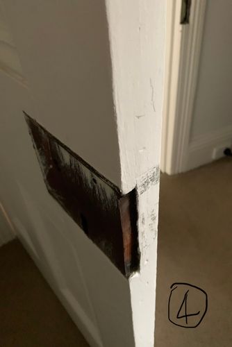

Second problem ,the flush pull of new handle is 7mm length,but the old is 12mm, much bigger than new one. (Image3)The old handle also left a gouge in the door.( image 4)I need your guild to fill these holes and gouge before I install a new handle.The thickness of the door is 40mm. Thank you so much!

photo: 4 clean all edges with sharp chisel cut a section of timber to suite the rebate glue in place sand back and fill any small gaps with filler sand to finish
