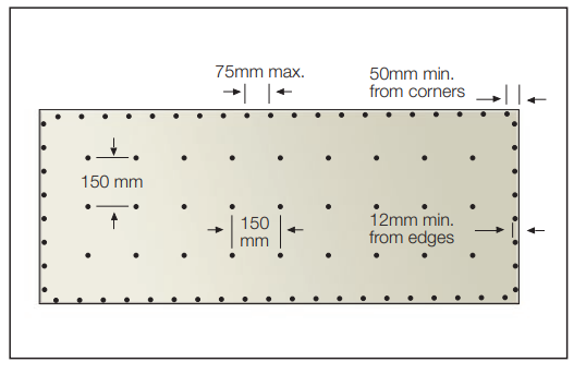

Unfortunately, I am not aware of a fibre cement sheeting product that can be installed without any mechanical fasteners like you are proposing, and I can't say I am confident that you would find a fibre cement sheeting manufacturer who would recommend a method of installing fibre cement sheeting without mechanical fasteners.
You'll note that a fibre cement sheeting product like Hardie™ Ceramic Tile Underlay, as per the Installation Guide requires a large number of mechanical fasteners.

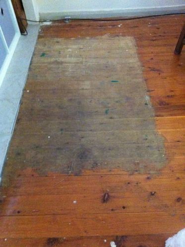

Now thats an interesting question, when I moved in to my place and pulled up teh carpet I found a very rough section of floor that had been covered with bricks of some kind, the floor had also dipped with the weight of whatever was there. I presume a potbelly stove and associated brickwork for the floor an wall.
This was what I uncovered, pretty much a non finished floor and gritty.

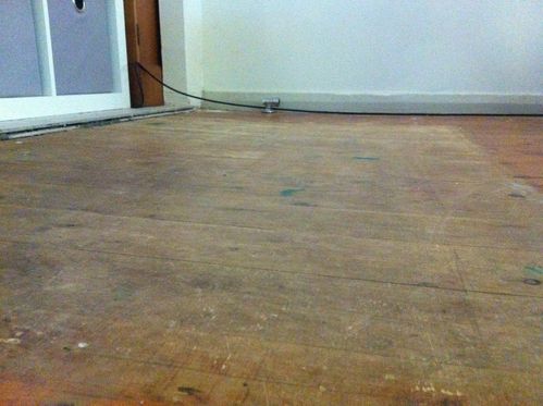

It sanded out and came up nice tho.
Maybe you dont need to attach it to the floor, If its heavy enough it wont shift? Or use a fixing agent in the corners only?
The main thing I want to bring to attention is if your floor has been ok'd to take the weight oevr a long term. This is the result of an old standard for garages and having a lot of weight above plus I suspect a water leak Levelling a timber floor.
Just something to factor in is all.
