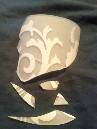

My son accidentally broke the glass light fixture in his bedroom 😣  I'm guessing it would be a little difficult to track down this exact fixture and as I'm in a rental, I need to fix it properly.  Any recommendations as to which glue would be best to use and/or any advice as to the best way to fix it please would be much appreciated.

Thank you for your help and I've uploaded photos as you suggested.

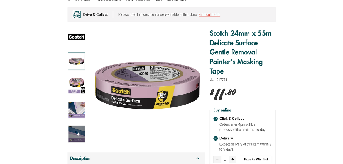

Definitely fixable! I second @MitchellMc 's suggestion Loctite 3g Glass Adhesive ! For sure will will glue this beauty back together. I suggest to use Scotch gentle tape to keep the glass together while the glue dries. Once the glue has set gently take the tape off and you should have a very nice lamp shade again. Good luck and stay safe.

Screenshot_2021-03-01 Scotch 24mm x 55m Delicate Surface Gentle Removal Painter's Masking Tape.png

I think you'll find the Loctite 3g Glass Adhesive suitable to fix that lamp shade @Storm77. If all the pieces are large like those in your picture, then jigsawing them back together shouldn't be too much of an issue.
Is this a matching shade to others in the house? If not, accidents happen, and if you struggle to repair the shade, you could replace it with something in a similar style.
