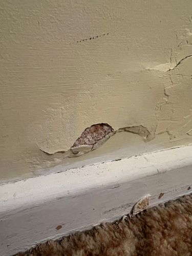

Good evening
Anyone know what happen with the wall in living here ?
And how can i fix it ?
Thank you very much

It appears to be a rendered brick wall and the white substance on the brick might be efflorescence, the white, powdery deposit often seen on concrete, brick and masonry, can be caused by hydrostatic pressure. This pressure occurs when moisture, under pressure from the ground, rises through the building material and carries dissolved salts to the surface. As the water evaporates, it leaves behind the white mineral salts, resulting in efflorescence.
This water under pressure also has the ability to push paint, sealer or render off its surface. Can you please tell us what is behind this wall? Is there plumbing or pipework behind this wall? This is just a guess on my part as your picture appears to show efflorescence. If there is no leak and it just happens that the brick surface is dusty the old render must be removed and repatched using Dunlop 20kg Multipurpose Acrylic Render. Once the render has been patched all that is left is to paint the surface to match the existing wall colour.

behind wall is bathroom
Re: problem with wall inside the house
Hi @Jackle1,
Considering there is a bathroom on the other side of the wall, I would suggest you have it inspected for leaks before considering any repairs on this side of the wall.
If there is a leak present, then any aesthetic repair will be wasted as it will likely return.
You could contact a leak detection specialist for their assistance with this.
