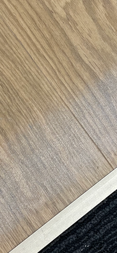

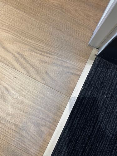

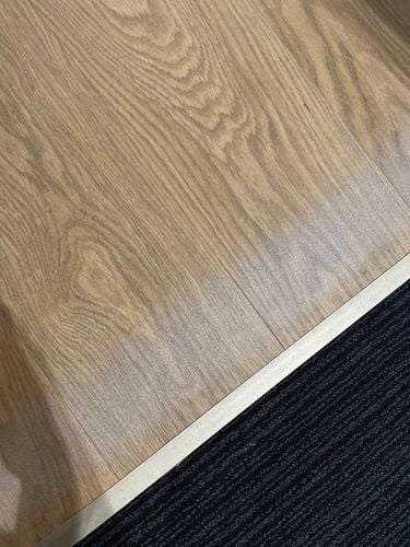

I placed a damp towel at the base of my door on my laminate flooring on a daily basis. This resulted in white discolouration and small cracks in the top coat of the flooring. I need to get it back to its near new
condition. Any suggestions would be great!

I suggest using Waxstix Tasmanian Oak Touch Up Crayon. You need to bring colour back to the bleached area of the floor. There are several choices in Waxstix colours, I recommend getting a few different colours to match your existing floor. Test a small area by rubbing the stick on the damaged area. Your goal is to blend the faded area into the existing colour around it. Don't apply too much force as the Waxstix will imbed itself over the entire surface of the laminate floor.
Please keep in mind that this is a cosmetic fix and will eventually fade. The Waxstix must be applied again to maintain the look.
