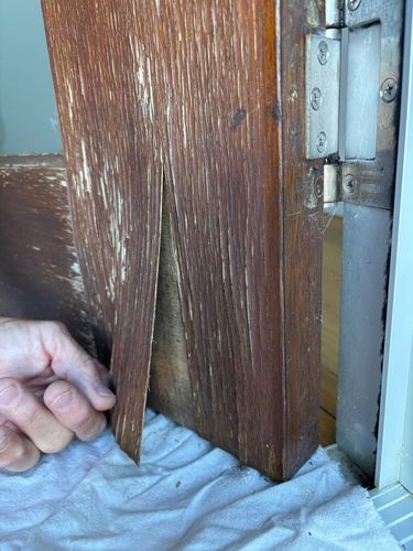

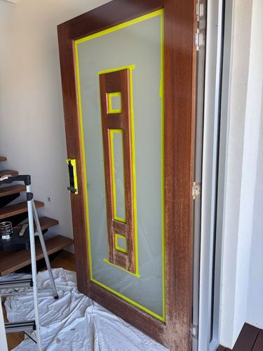

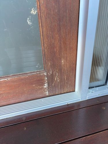

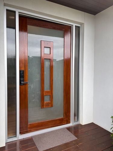

as @EricL mentioned this isn't going to be an easy fix. However I can offer a lot on insight into a similar scenario where a clients very expensive front door delaminated due to lack of maintenance and weather damage. The attached photos basically show the process and result. I stepped it out as I have been meaning to share the project.
1. Make cuts along the grain with a sharp blade where the bubbled areas are.
2. Lift each side and fill with a quality wood glue
3. Use a spatula to press down the area and squeeze the excess glue out.
4. Use a damp cloth to wipe excess
5. Rest something like clean flat metal that the glue wont stick to and then place a heavy object on top and leave for a few hours. I clamped and stapled this to the door. I had to repeat in a few small edge spots that didn't take.
6. Next day give it a light sand over the repair areas and use the best matching timber filler and allow it to fully harden. then sand and repeat if required.
7. Light to medium sand as required entire table top and apply your choice of oil.
